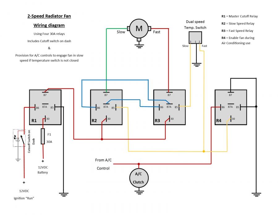

I designed my own relay circuit for it. Drawings to be posted next week.
My circuit uses 4 relays;
1 master cutoff relay
2 slow speed relay
3 fast speed relay
4 relay to make sure fan runs when A/C compressor is running.

Here is the wiring diagram I mentioned. It is functioning fine in my truck. My fan is installed on a sheet of plexiglass right now, But I will replace that with Lexan which is stronger and less brittle, so it should withstand bumps and vibrations better.

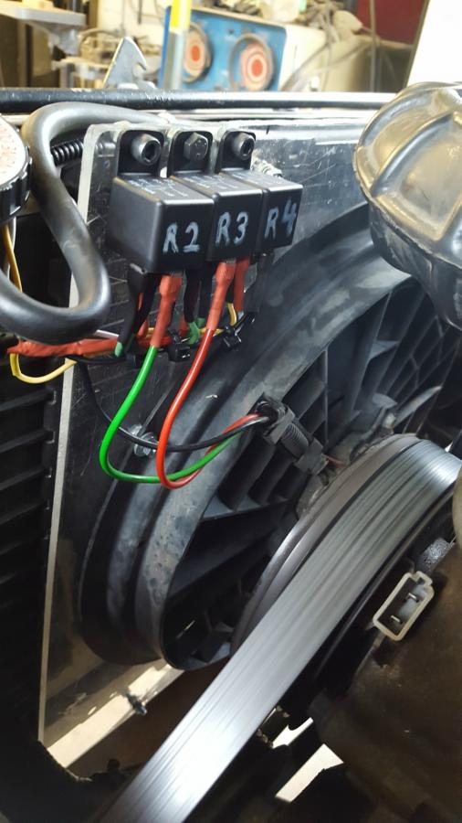

3 of the relays are bolted to the top of the fan support. The main cutoff relay (R1) is in the underhood fuse/relay box. That took a bit of work, but I like the result. I repurposed the Power door locks fuse as a fuse for this since it was already wired.

Interesting, I'll be watching this. Will probably be doing a 2 speed fan on one or both of my Rangers.
Got to refresh myself on relay wiring so I'll know what you are doing with the blue wires in the middle, but I assume it's to keep both relays from going active at the same time?
Looks like you've got the fast and slow sides of the BMW Temp Switch swapped and run to the wrong relay. May be wrong about that though.

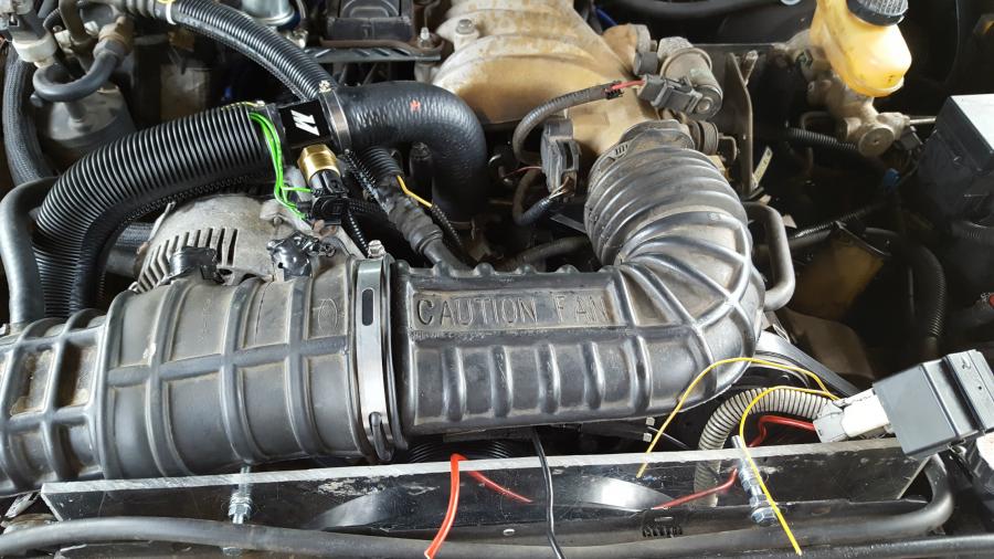

Nice...but I must ask...is that plexiglass you mounted the fan on or aluminum?
Either one will work...but I thought aluminum would be a better material for that application...aside from the fact that plexiglass prices are ridiculous. A sheet that size in Canada can run you $50 to $75...at least the last time I priced it...

Yes, the blue wired are the electrical interlock to prevent energizing both speeds simultaneously.

I think this is plexiglass. It is what I had on hand and is temporary. I think plexiglass is too brittle, so I will soon replace it with Lexan or aluminum.
