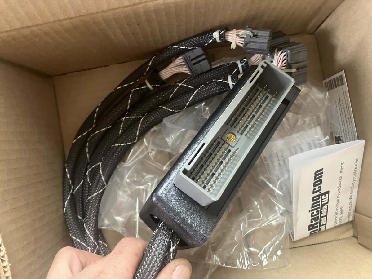

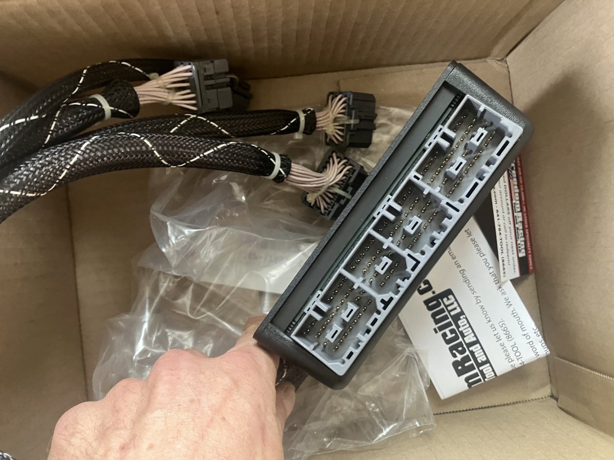

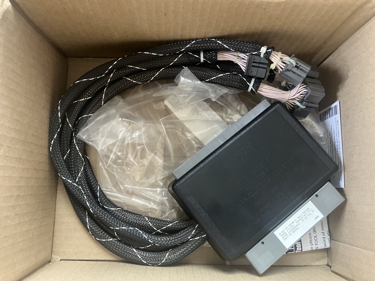

Bought this thinking it would help with my ecu changeover. Ditching the factory unit for a speeduino.
Would love to eventually develope a near plug and play ecu for certain rangers & B2’s
Looking at it seems I’m just digging deeper into the rabbit hole.
anyone recognize this?
I believe that's a breakout box adapter to adapt one of the import Fords (Mazda, Nissan etc.) to the Rotunda 104 (105?) pin breakout box. You would plug the multiple connectors into the import PCM and the vehicle harness into the box, then the 104 (105?) pin breakout box would plug in to the wide connector on the box.
I thought those plugs looked foreign, couldn’t see them on the website pic before purchase, good thing it was kinda cheap.
