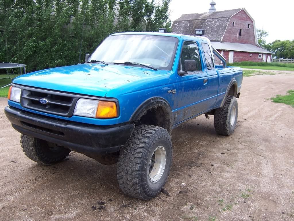

I blew a 4R55E and then swapped in a 5R55E (which the guy assured me was fine) but it has a weak sprag clutch so it takes 2-3 seconds to engage in gear, and also flares up between shifts. Lame. Also the 4.0L even with headers and a BBK throttle body seems sluggish. So I said enough is enough. I listed my truck for sale, but then a deal came up for a low km v8 explorer that has the same year as my truck, near unheard of in this small province. So I said what the heck, bought it, that brings us up to now. You now know the story of Dweano and his Ranger.

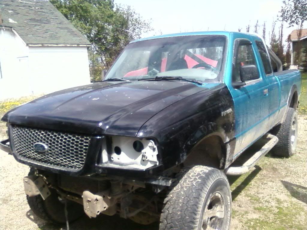

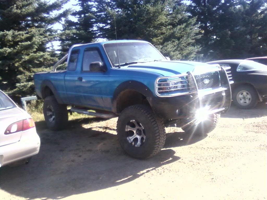

Hey bud good to see youre still alive. Take a look at my Rangebe V2.0 build, it will answer some of your questions.
Man I really like that front end conversion! I think I want to gather parts for mine now!
Still alive! Haha. Just been ignoring trucks for awhile because of other pressing life concerns, but with a good ish deal on a complete parts vehicle, I said why not! I will check out your build and likely PM you in a month or two for help
It looks real good! I got a 2001 Edge, swapped the front ends around, the sold the Edge and got enough money back to pay for the cost of painting and I think $150 extra. Whoop Whoop. Add some 2005+ (i think) flares and 2001 mirrors and it looks real sharp!
