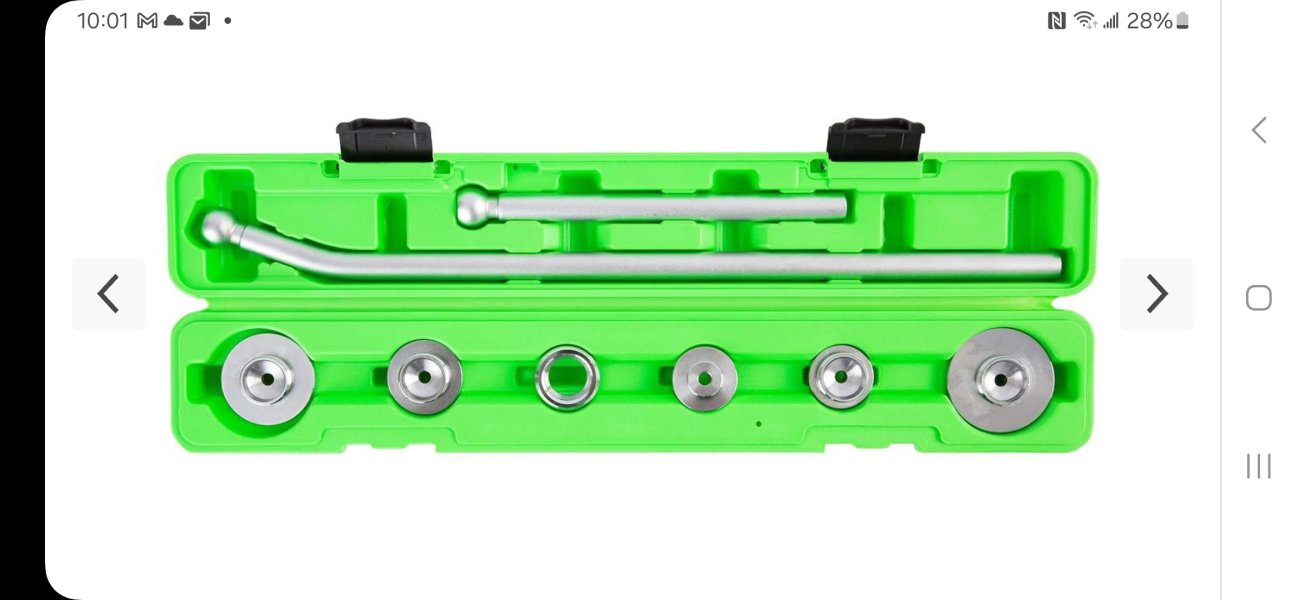

For casting plugs in the rear of the cylinder head... they're a B. Letting the rear of engine swing down and using the proper driver... some have been done.

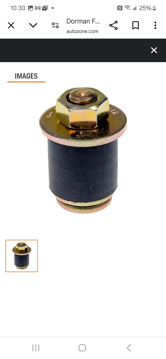

They do make expandable plugs too. If you can get the room at a metal one... do it. If not...

Are those loaners? WHERE from and WHAT are they called????
