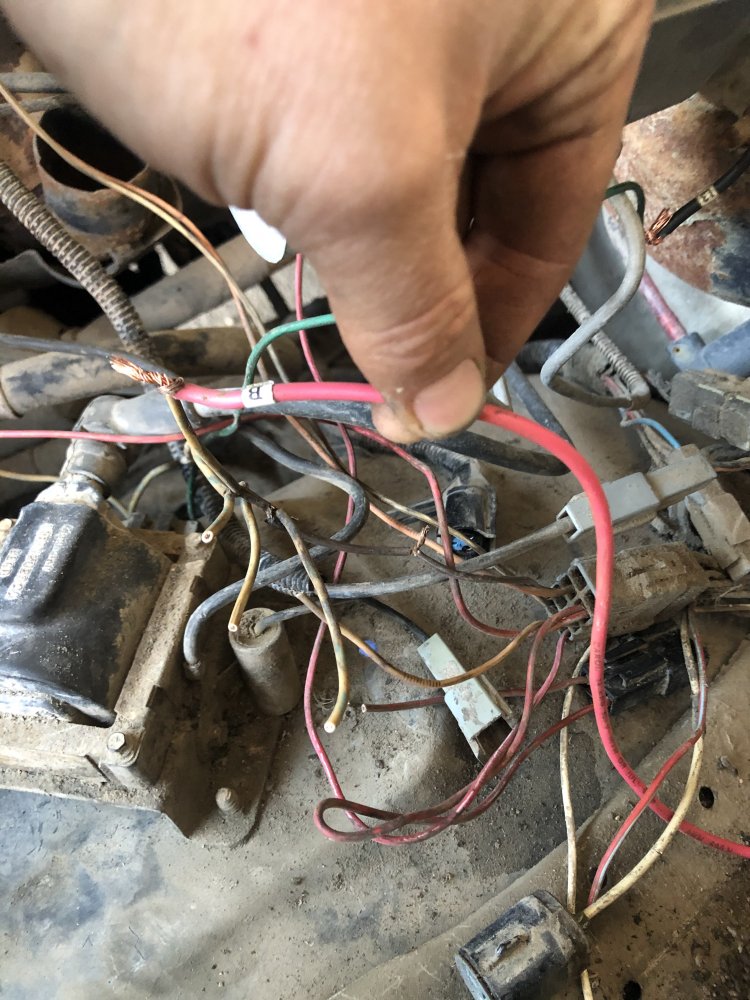

I have a durspark distributor and the stock 84 coil. I don’t have the red wire hooked up to the coil. I have a purple wire that goes to yellow to the coil.i have the HEI module wired like the diagram. It had spark before I tore the computer wiring out and now it don’t.

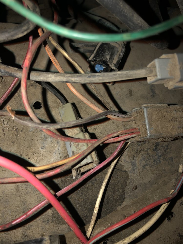

Here is the “main plug” in

Thanks for all your help. I found a red wire with green strip it come from the main harness to another plug in. Not the main 6 wire plug in I’m just not sure what to use??‍♂️.

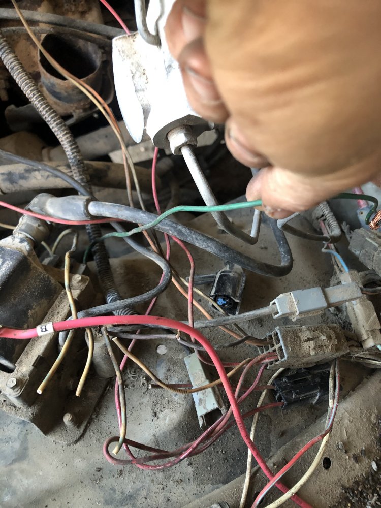

This purple wire (circled in red) was connected to about 5 yellow wires that originally went to the stock 84 coil.

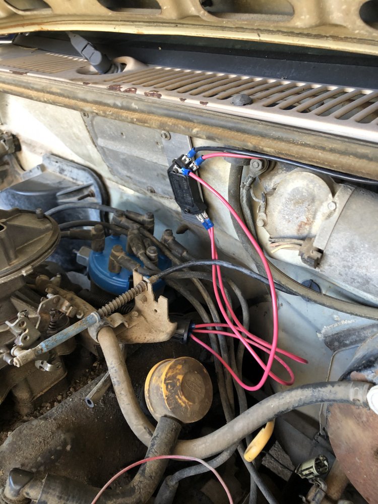

I have the hei all wired up rough I will make it nicer once it runs.
