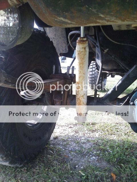

Both pics are with full weight on rear axle...you can see how the axle is positioned closer to the front of the vehicle.
My thoughts are to redrill the leaf spring two inches behind current center pin and run dual center/alignment pins just like the newer F150s. From the info I have researched, as long as the points of the spring which are drilled are supported between the perch and u-bolt plate, it doesnt allow flex in that region of the spring, therefore, not creating a weak spot as redrilling normally would. This would offset the axle between 1-2" while still keeping a center pin the original hole, and help secure the axle to the spring much better. And of course would require me to redrill my perch and spring plates to accommodate the modification.

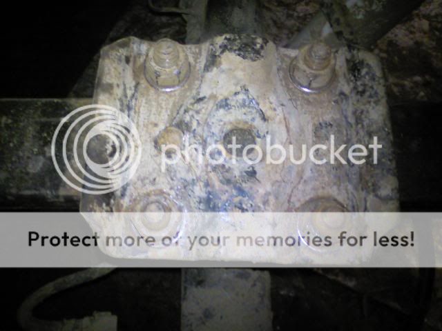

I drilled new holes in my perch an U-Bolt plate to shift my axle forward 1.5"
No Issues in the last 3 yrs

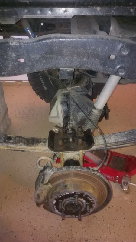

Here are a few pics from way back when I did it. In these pictures I still had a stock block, so I drilled the a hole for the center pin in the top of the block, not the perch
Then later I lowered the truck back down a few inches with softer coils and a new radius arm setup, so I swapped the stock block for a 3/4" solid block I made. I drilled and tapped them to add a centered bolt for the perch, then an offset hole for the actual leave pack center bolt.
So I guess looking back.. I lied. I didn't drill offset holes I the perch because them my block would be half off the perch, but if you don't need a block, you could just drill the perch and U-Bolt plate. (Like the Ruff Stuff 8.8 swap kit)
