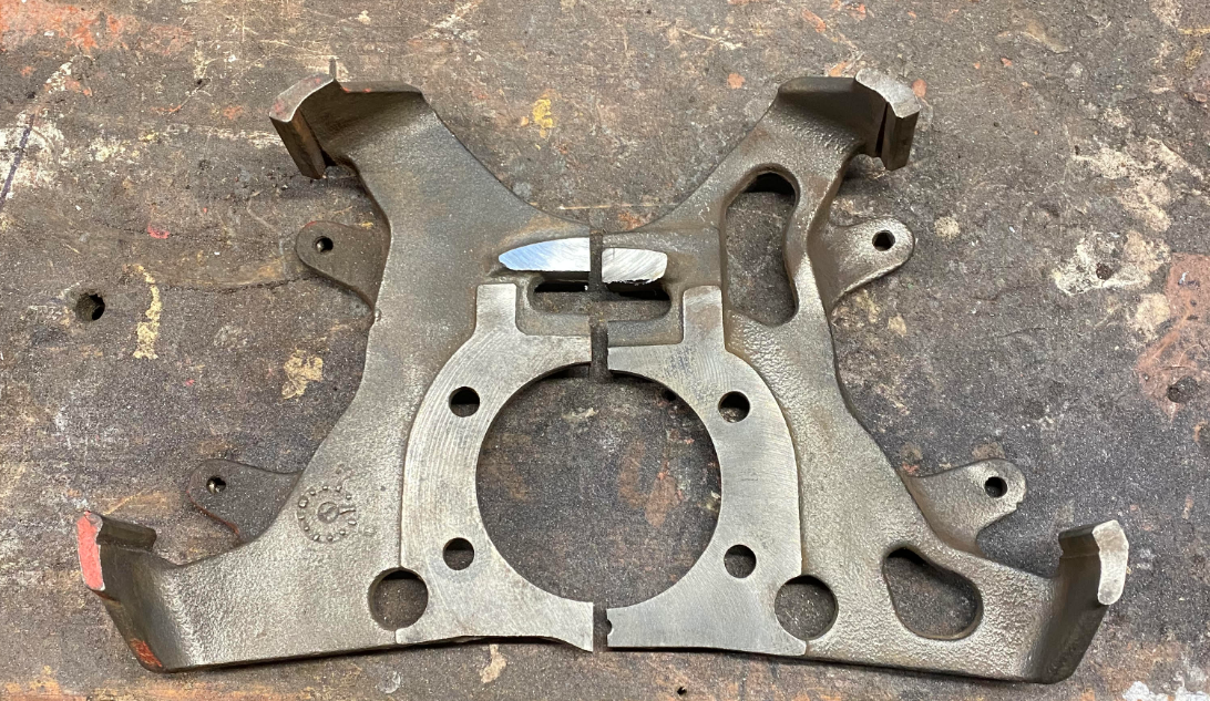

I have an explorer 8.8 and i want to run a hydro in it, but i cannot find a dual caliper bracket anywhere, i saw some guy cut and welded 2 of the caliper brackets together to achieve this goal but i am a novice metal fabricator and don’t trust that everything would line up, aftermarket makes a bunch of options for the sn95, does anybody know it i can slap sn95 brakes on an explorer rear? they are both 8.8s and based on the research i’ve been trying to do it seems they’ll fit but wanting to hear anyone’s advise/experience

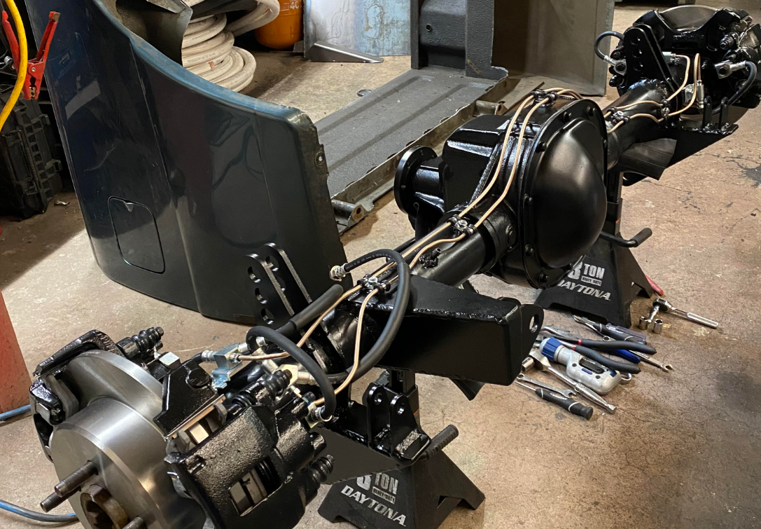

I assume this is the homemade one you saw...
72392
Try this one... it’s a little pricey:

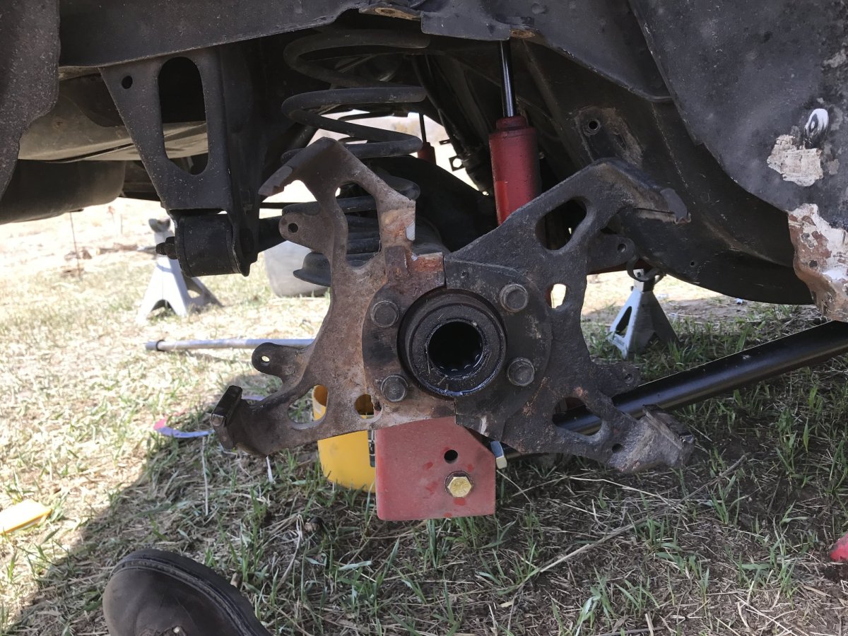

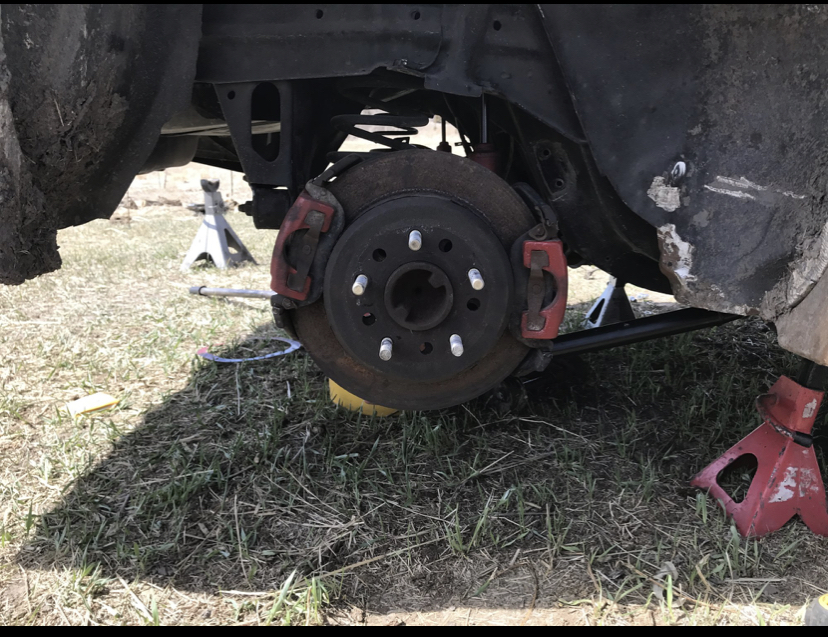

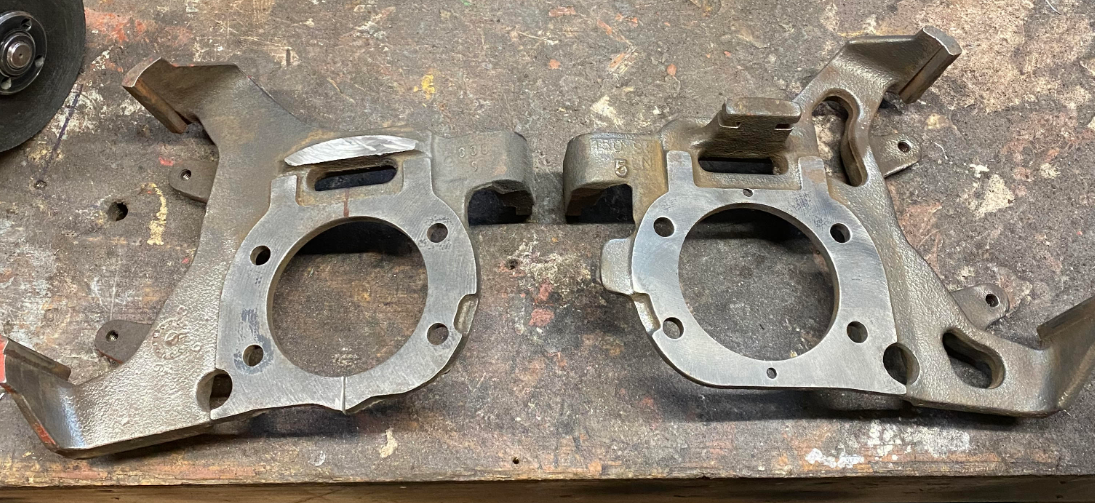

I probably wouldn’t spend $1300 on the setup I posted... I’d sooner make the homemade system from the first pic I posted.
He cut both a left and right side caliper bracket in half, bolted them on the same axle flange, then welded them together.

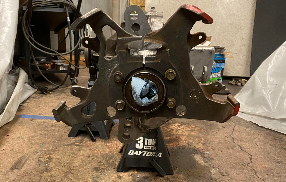

72575
But then you don't have the pricey Winwood calipers :icon_twisted:
I hadn't noticed that the front and rear caliper brackets weren't mirrors before. But then I can't weld cast worth $#!+, so I definitely wouldn't mess with it on brakes. But it does give me some ideas for my project.
3/8 plate and some drill and grinder work ....run the jp6 calipers and a set of stang calipers for parking brakes.
so you have parking brakes and drift brakes
Easy to make.
