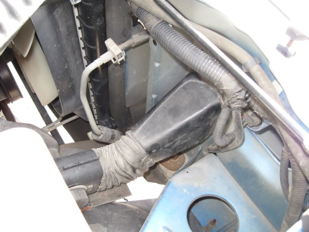

The air intake when i bought it(used with a k&n filter) is about level with my lights. Ill have pictures when i figure out what im doing

The air box IS level with the lights, but if you look at how it is connected, it is probably ported through the fender int othe body, which is actually level with the top of the bumper.
The tire can throw a wave of water up under there and will easily submerge that intake port as you drive through it (especially if you're trying to have fun by going fast).
I've ingested water into mine merely playing in 3" deep water next to the curb :shok: Fortunately it was nothing more than to cause the engine to run poorly for a few minutes.
The intake arrangement was redesigned in '95, not sure if it still as vulnerable to water ingestion or not.

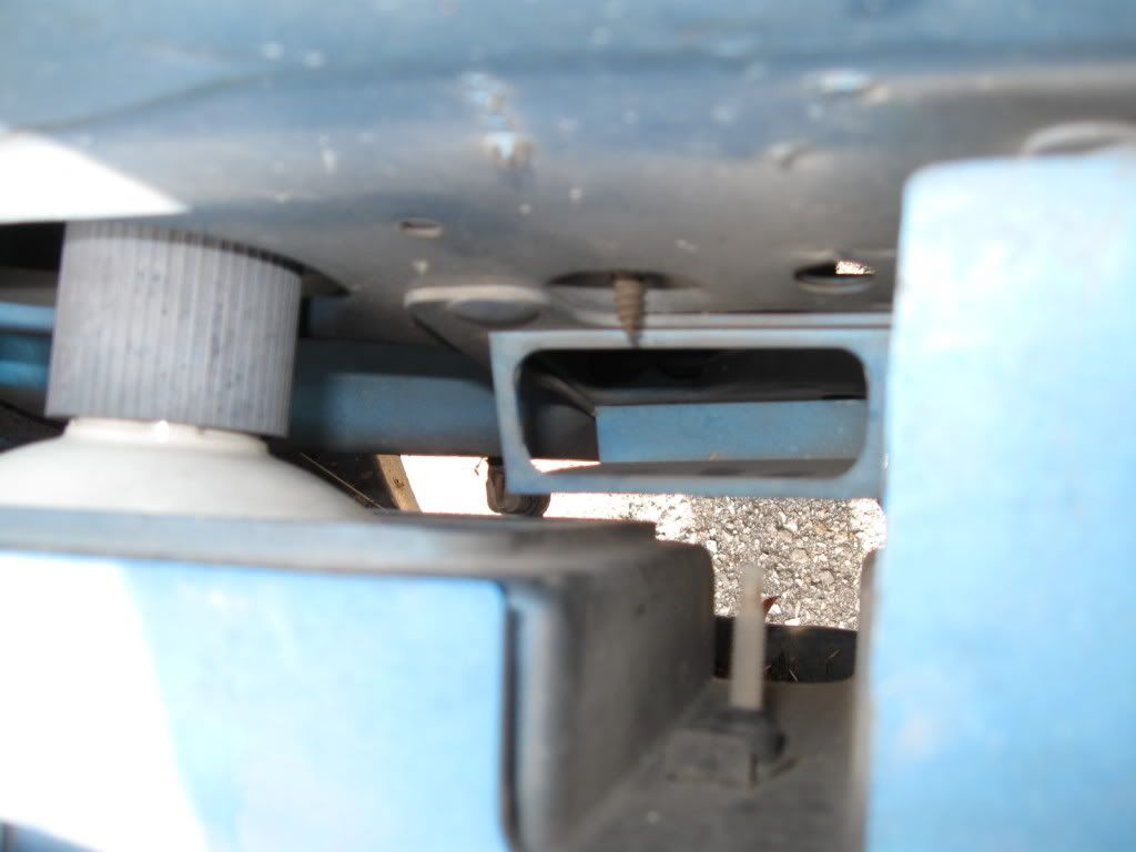

now pictures of the intake
there are other pictures in the album
ok its not showing the pictures??????
You pasted the URL of the page the picture is on, you have to paste the URL of the picture itself (provided in the box under each thumbnail).
I fixed it for ya.
