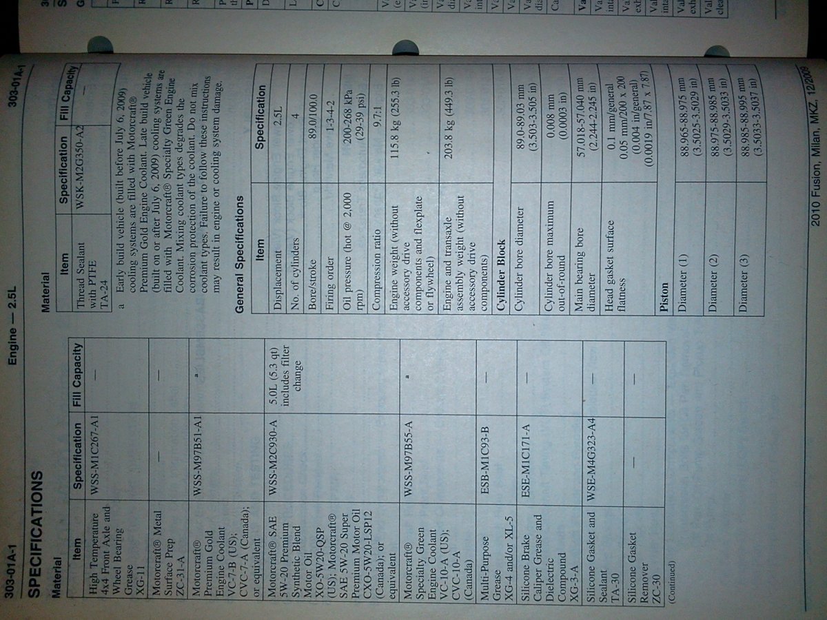

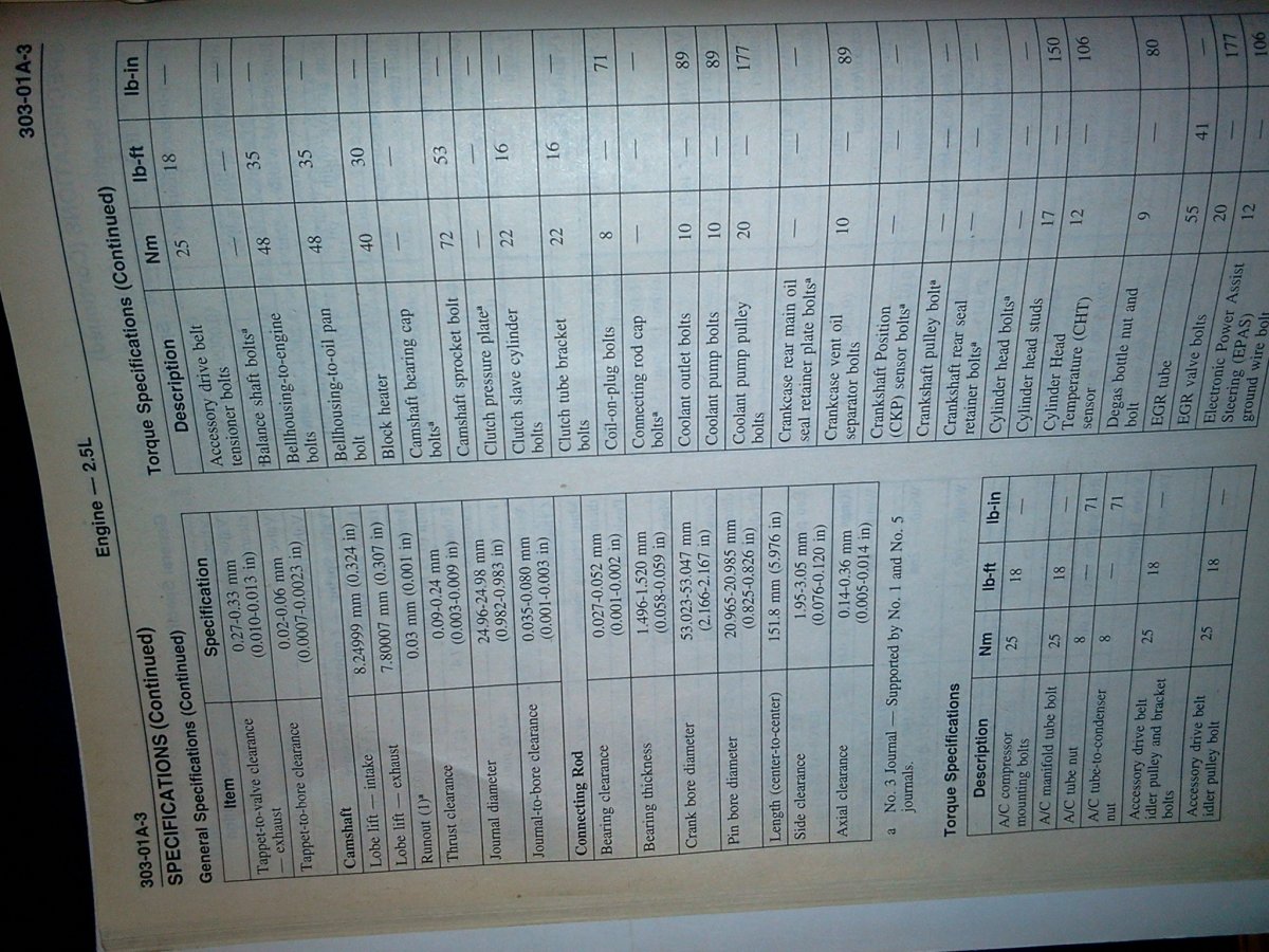

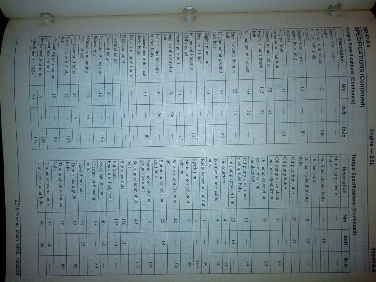

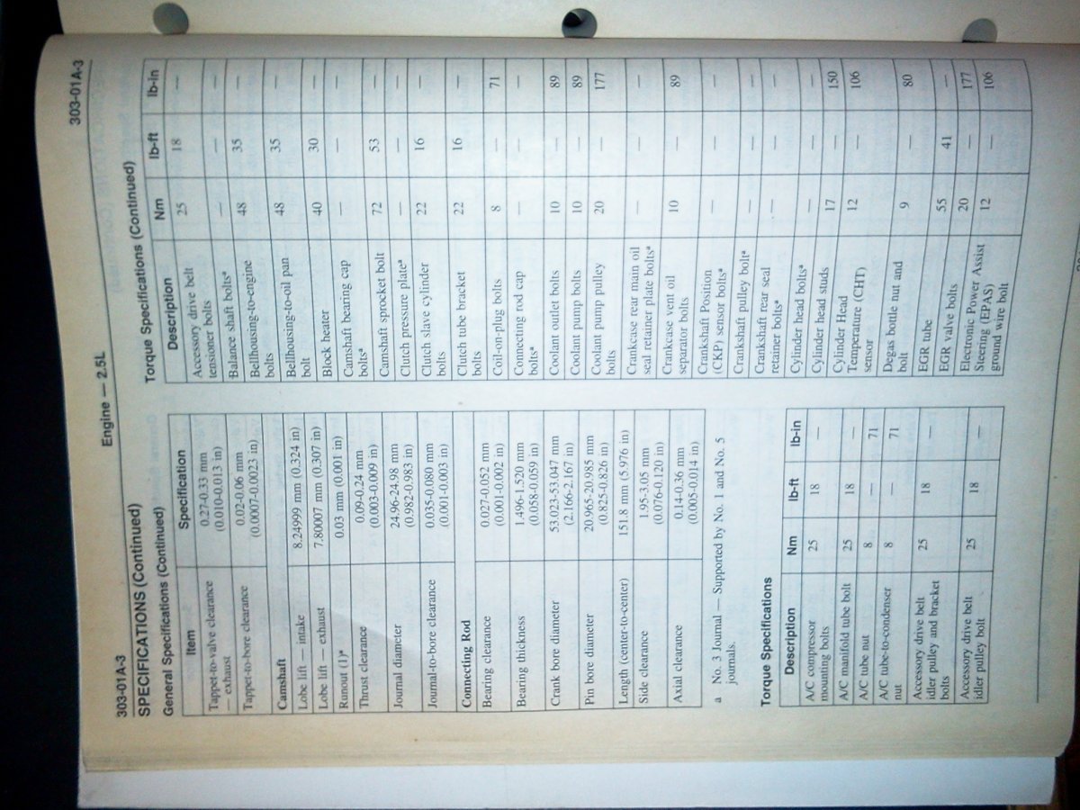

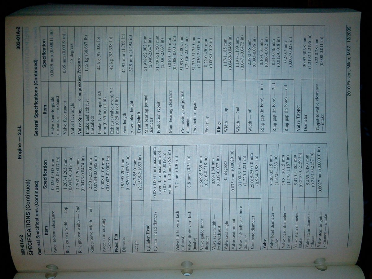

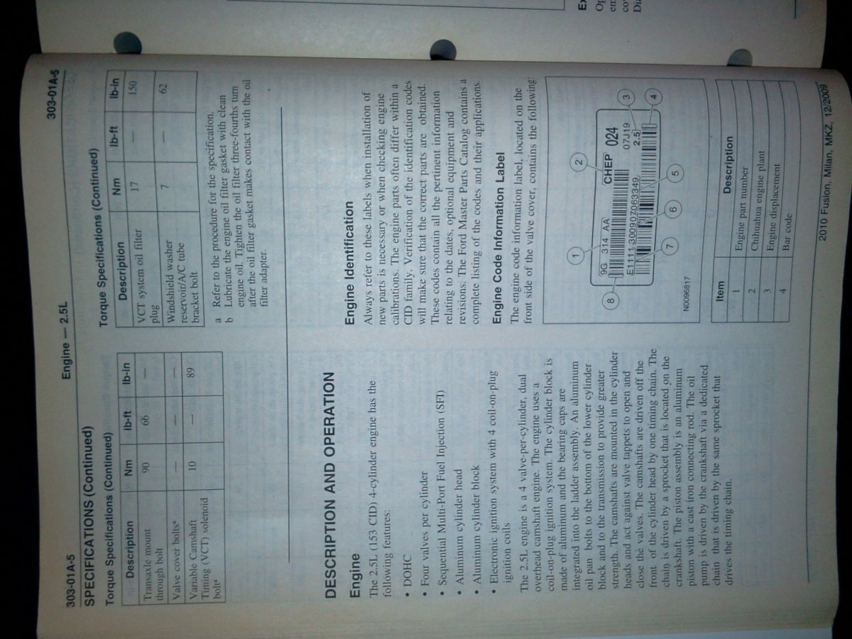

Pretty much what I ran into. I'm going to mic the existing stuff and order accordingly. 3.50 is spot on for the bore.
2010 factory manual
