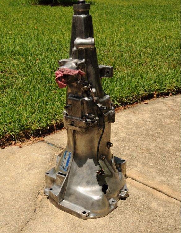

if it is the tk4 i think you can swap your bell to a fm146 or fm145 from a gen one ranger
Its not, the transmission looks like this
I found out that the transmission wasnt offered in 4wd, so now im deciding what transfer case to use. A dana 24, or a samurai divorced unit
