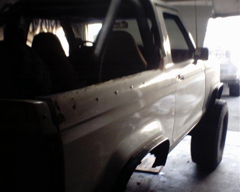

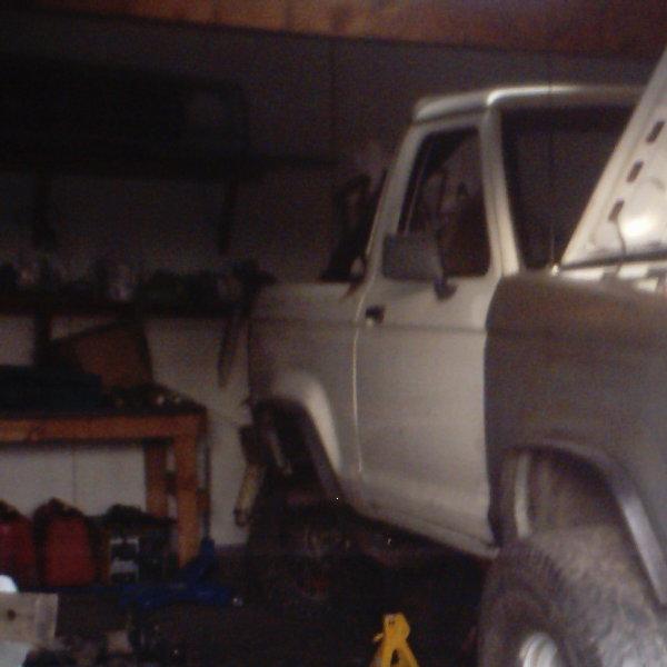

ok thanks...send me ur email addy ill send u some progress pics.
Just post them up here. Everyone will want to see them.

i posted em ...did ya see em..?...have q for u ...will the exploder d-shaft fit to the 1350..? and 1350 is the stock t-case right?
The Explorer front drive shaft will not fit on the BW1350 transfer case.
The BW1350 is the stock transfer case in the BII's.
I didn't see your pictures. Post a link here.
