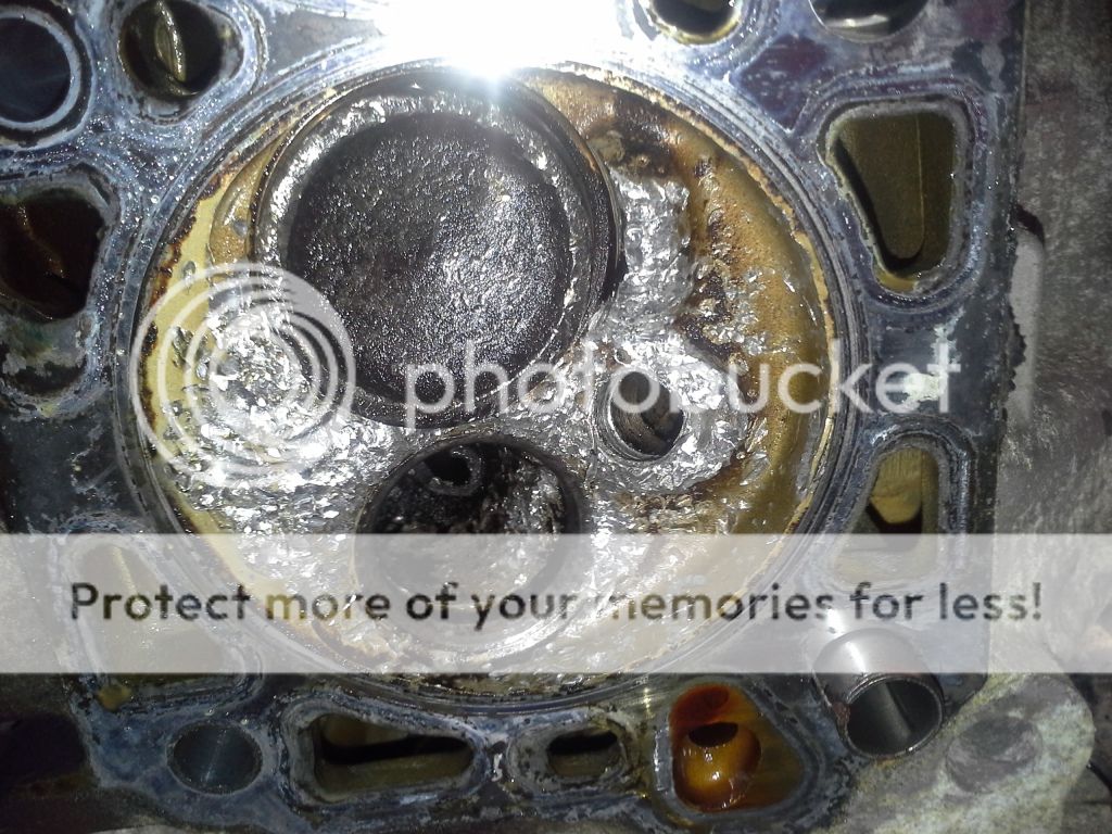

Just for fun, here is a pic of a cylinder that got a hole punched in the piston when the exhaust valve dropped.
The dark spots are damage to the block where it got hit. If it went in the injector hole it wasn't as big as a valve, but it could still have done damage to the cylinder wall. Also, to punch through the piston it has to be big enough to touch the head before the piston gets to the top. Similar to a valve.
Here is the head from that cylinder.
Don't think for a second that you won't need a new head.
