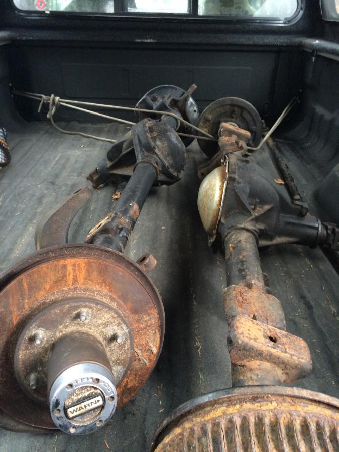

I'm going to SAS this summer and am starting to get my parts all lined up. Its an around towner and drive to the trail rig and I'm planning on running 35in-37in tires depending on availability and prices.
I have a front 79 F250 dana 44 and a chevy ?? rear dana 44. Both axles are 4.56 gearing. My plan is to pick up a set of 63" chevy leafs for the rear and explorer leafs for the front with my ranger main leaf added. Plan on buying hangers and mounts from ballistic fab or ruff stuff. Opinions on front vs rear shackle position in the front? I know the front shackle will keep me lower which is what I want.
The Ford 44 was converted to 6 lug chevy outers (meaning from the knuckle out correct?) to match the rear. Does this include brakes? The calipers are missing from the front and they must be chevy brakes considering the lugs go through the rotor? How do I know what calipers to buy exactly?
For steering I'm going with a IFS toyota box with custom linkage built from DOM and rod ends from ballistic fab. Trying to run high steer. The axle does have a high steer arm on it just not sure where it came from or much about it.
This is the last picture of the axles I have before I had to go back to school, today, 2.5 hours from home. Thoughts on the plan or what I should do about brakes? Can anyone ID the high steer arm?

Also the VSS is in my rear 8.8. I realize that something must be done with it. Do I go for a FW 8.8 out of a F150 or redo the transfer case to the year that had the VSS there as opposed to the axle?
Throw the rear 44 in the garbage. Get a fw 8.8...
SVT
That rear looks more like a GM Corporate axle (10-bolt or 12-bolt maybe).
Still agree though, a Ford 8.8" is a much better axle, but do avoid '83-'86 8.8s (unless you plan to swap in a full-carrier-replacement locker such as ARB or Detroit, then disregard).
Rear shackles will give you a smoother ride. Rear shackles also require you have a much longer slip-spline on the front driveshaft, but IMO I think the better ride is worth it (mounting the shackle through the frame, rather than under it, can keep the height down a bit).
Going to purchase the ford 9.75 from the jy tomorrow. Has the vss and disc brakes all I need to do is match the gears to the front and adjust the perches to fit the rail width of the frame. After that let the chopping begin.

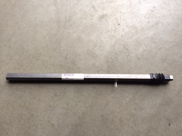

On a more exciting note my steering shaft is starting to come in. Heres the shaft itself now I just need my joints.

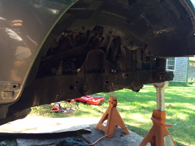

Front end is removed. Plasma cutter or torch would have been nice but the grinder did the job.
No turning back now!!

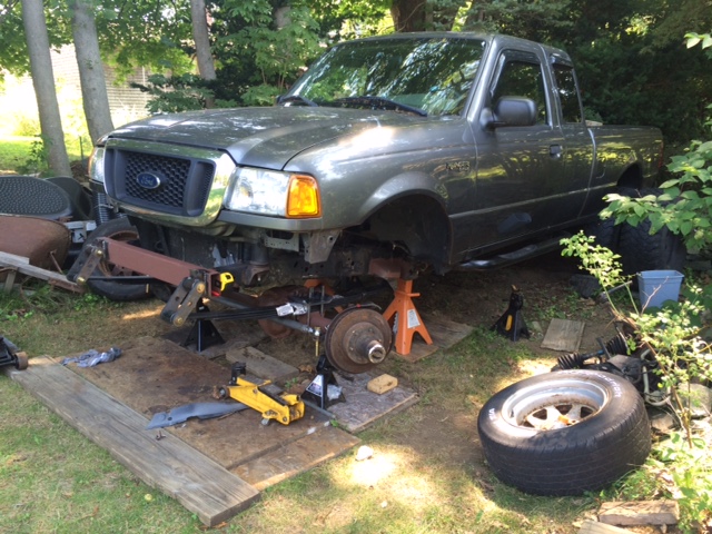

Heres a sneek peek of whats starting to come together. Going with an unorthodox mount for front shackles but it should work. More to come soon.
the ford 9.75 is a metric hub centric pattern last i knew.... but it may be an easy fix.
that looks like some wormy ass rectangle tube you got. could just be the picture... i would run a spreader in there and cap the ends if its less then 1/4 inch....
front shackles are fine. depending on what your doing as far as ride height and the actual working spring geometry, there is no harsh noticeable difference in ride. at least not on my truck....but that changes depending where the hangers are mounted and angle of the spring and the shackle angle and length of shackle of course......where it hurts you is when climbing stuff. but when i was rear shackle i was folding springs up like cheap lawn chairs and ripping the drive shaft apart....so front shackle it stays on mine..

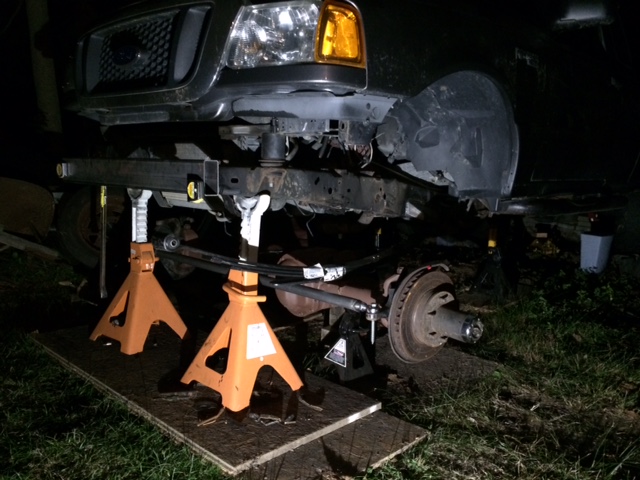

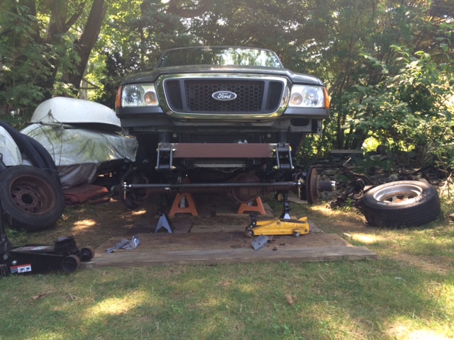

Ordered an add a leaf to gain some more steering clearance and also a flat pitman arm rather than the drop one I had. Getting some stock to plate the frame then its time for mock up. Sitting on its own weight now.
that shackle angle is not close to ideal ime...when the springs are flat your really asking for it..
definitely beef up the spring rate or remount it tighter and see if it holds. i have had that happen with waggy springs before. it has to be a rate thing, some or ok with a v8 others were whopped flat with a 6....ame part number different results...odd.
how are you dealing with the metric pattern on the rear axle??
