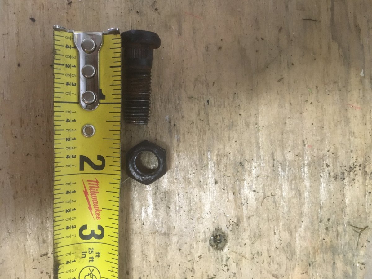

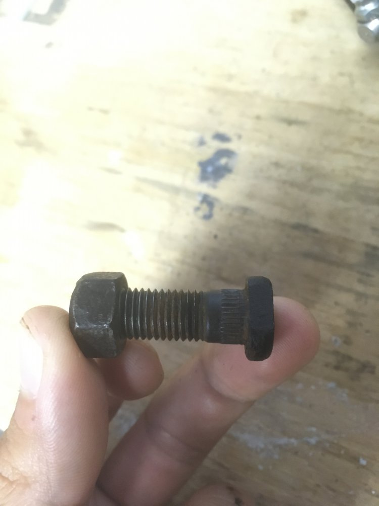

Here are a couple photos of the stud & nut together, and a measuring tape to give a rough idea of the dimensions.
You can see how the splines of the stud are a bit fatter than the threads, that seemed to be the only difference between the Dana 44 stud (not shown in the photos) & the Dana 35 stud (shown in both photos). Plus it's a tad longer, but not the issue.

Edit: In the tech section there is a spicer parts list for the D35 TTB. Spicer part number 42775 is the hex bolt you are looking for, I believe.
