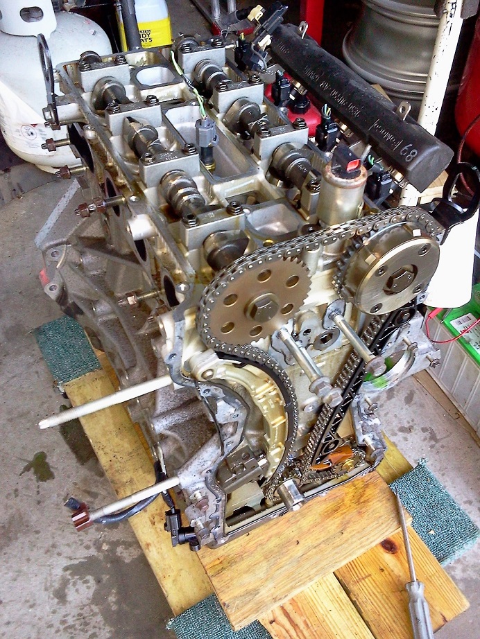

I am now committed, or at the very least should be committed.
2010 Fusion 2.5 details to follow as I make them up.
