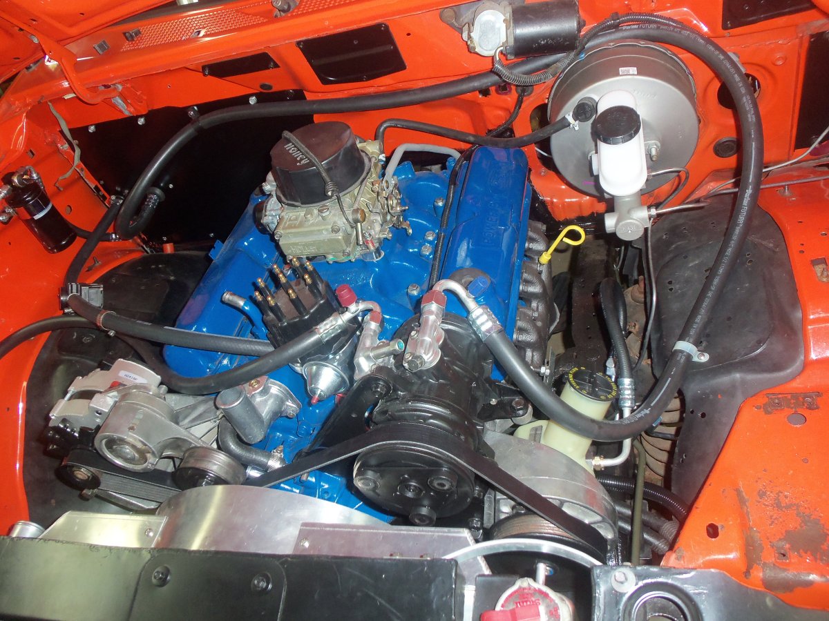

Yeah, a 302 should weigh less than a 351 and using the short snout stuff and whatnot from the Explorer variety, it will fit better in the engine bay. Mileage can be a little interesting. The 302/auto/AWD that I did with dad in his Ranger got 17/18 mpg if you could keep your foot from smashing the loud pedal all the time, and got about 15 if you were really on it. My green Ranger in stock form was essentially the same truck with 4.0/auto/4x4 and I got 13/14 mpg all the time. Same with my 92, 4.0/auto/4x4, but I was hitting closer to a solid 15 after doing some transmission tweaks in that. Dad’s 99 4.0/auto/4x4 gets 17 mpg. I’m really curious to see where my green Ranger ends up with my 302 swap, since I’ve done a few things different over the swap I did with dad including headers, minor gasket matching, changed gear ratios in the axles, etc. 302s still have a decent amount of aftermarket and options so you can really build them if you want

Personally, I’m of the opinion that the 302 and a small diesel (beyond only offered as an underpowered option for a few years early on and only on outside the US markets for newer Rangers) should have been motor options in Rangers. After having put together and driven a 302 powered Ranger, it’s a really nice match. With the exception of the Coyote 5.0 in the newer F-150s, I’ve heard from a number of people that had older F-150s with the 302/5.0 that said they weren’t the greatest in those, that the 300/4.9 straight 6 was a better workhorse for the full-size. But a Ranger with the 302? Awesome. A decent small diesel would be killer in one of these rigs, you would get some nice fuel economy numbers then.
