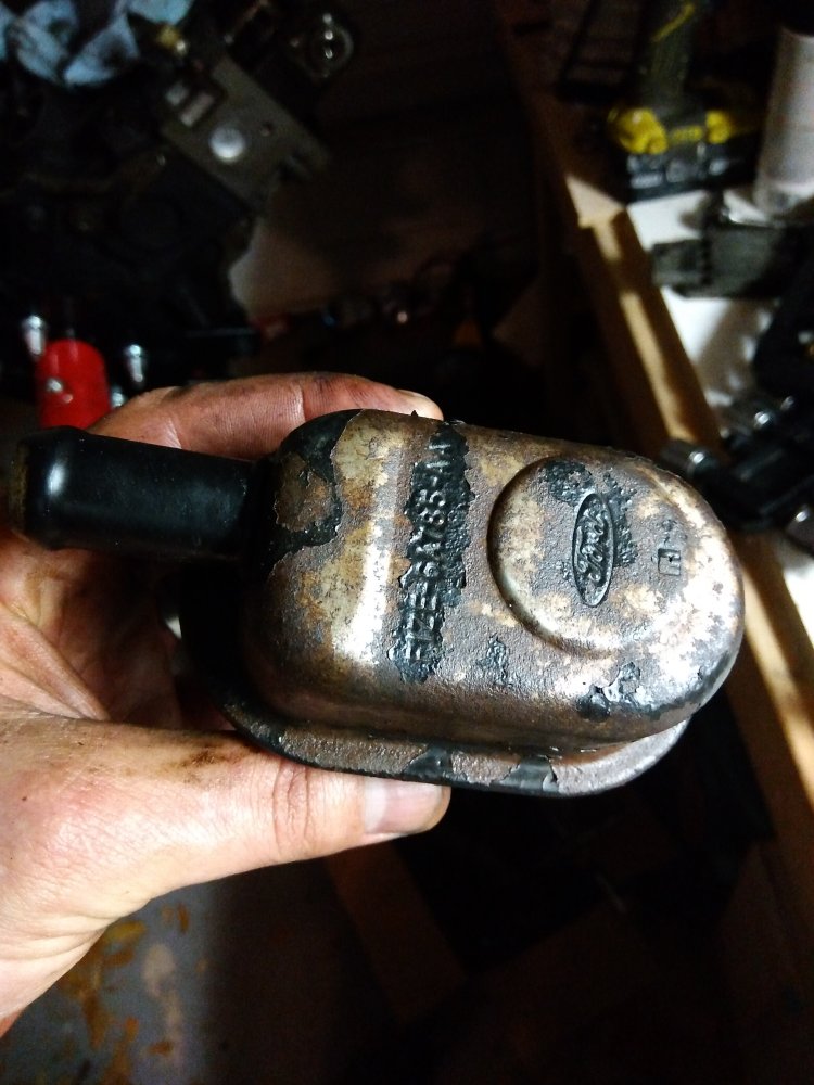

Yeah, but on my 93 2.3 l you can't find one to save your soul. eBay has old used junk for $50 bucks.
