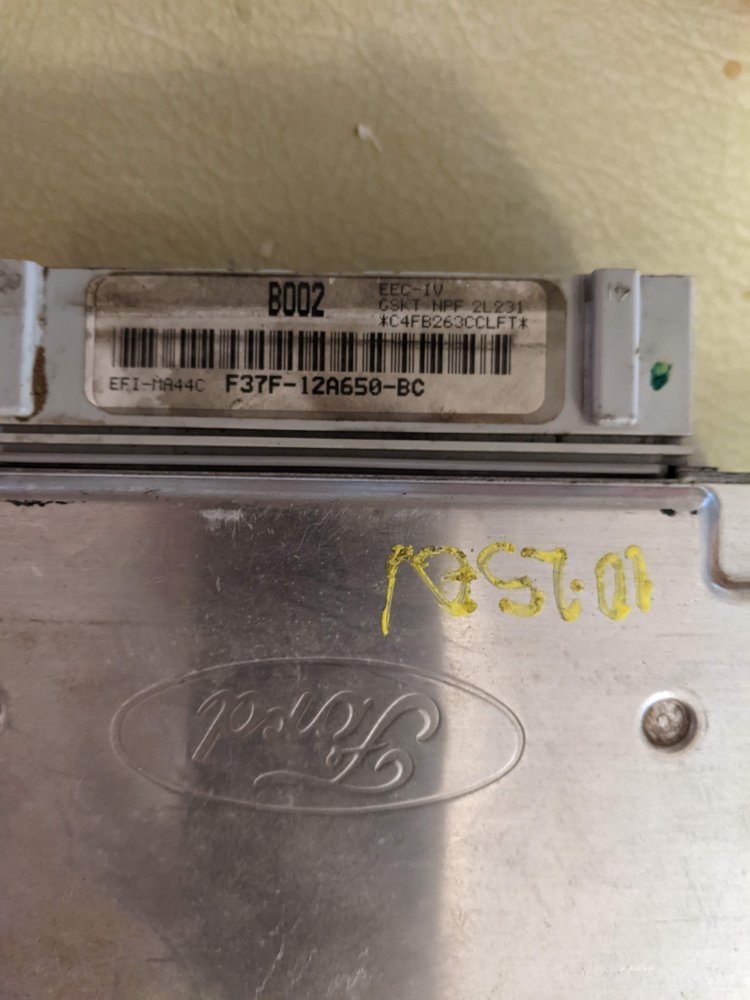

Thanks Ron! I pulled the old one and per Google it looks like it's the correct one. F37F-12A650-BC seems very popular for the 2.3 manual.
The only thing that looks like that software tag is B002 which isn't on the chart. It looks like it has a junkyard marking on it, and it's pretty crusty looking. Maybe later I'll peek inside at the capacitors. We have quite a few '94s in the U-Pull so hopefully I'll know soon if this is the issue. Here's a pic:
75019
Yes, B002 is the software
Yes, that is a wrecking yard mark
F37F is 1993
7 is Ranger specific, T was also used for "truck"
Just an update for anyone who might use this as a reference thread. The '94 PCMs didn't fix the problem, but seemed to work fine (as in everything was the same after a swap). Both '94 units had different codes but were the same as each other -- F47F-12A650-ADC, BAB2. If you have a 1994 2.3l 5-speed, that's probably the unit you want!
