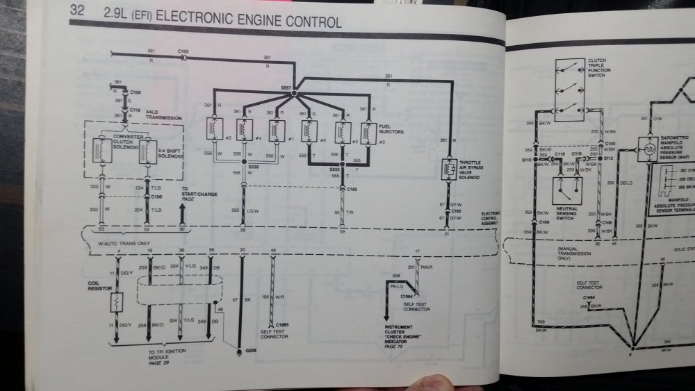

The '88 and '89 schematic shows another solenoid on pin 52 for the A4LD transmission (3-4 shift solenoid) that the '86 and '87 schematic does not show. Pin 53 is used for the A4LD shift solenoid in all these year models. Will the lack of wiring for the 3-4 shift solenoid on your '86 harness cause any issues with the '88 ECM that provides for it? I don't know. Maybe someone else in the forum knows, like @adsm08 or @RonD.
In the schematics the '87 is like the '86, and the '89 is like the '88.

Thanks for the additional info Paulos. It is strange that the 86/87 schematics only show the torque converter solenoid and not the overdrive/3-4 shift solenoid like the 88+ does. I always assumed all A4LDs had these two solenoids. I did notice that my original ECM has about 10 or so fewer pins then the 88, which has all of its pins.

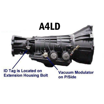

I just read that the '88 (and most likely later) A4LD has two solenoids and a 3-wire connector. Which makes sense, that the '86-87 would have one solenoid and a 2-wire connector. So the '86-87 ECM is clearly designed to work with the single solenoid, but the '88+ ECM's are made to work with two (that's the way I'm seeing it). All year models with the A4LD have the "lockup" solenoid which uses pin 53 in all cases. So I have to wonder if your trans will function correctly using the '88+ ECM's on your '86. I looked in the tech section at the Ranger Station, and it did not show different types of A4LD's. You might want to research the A4LD before getting the '88 ECM.
A few interesting things I found right away are:
And here :)
I suppose it's possible that the '88 ECM would work in regards to the missing 3-4 shift solenoid; but you would probably have that code 86 all the time.
