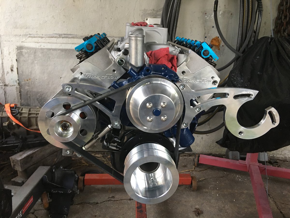

Is the w/p the correct flow direction? Is it setup for serpentine belt or v-belt?
I pulled the water pump to triple check it was the correct rotation. I have a CVF racing 8 rib belt system set up installed.
