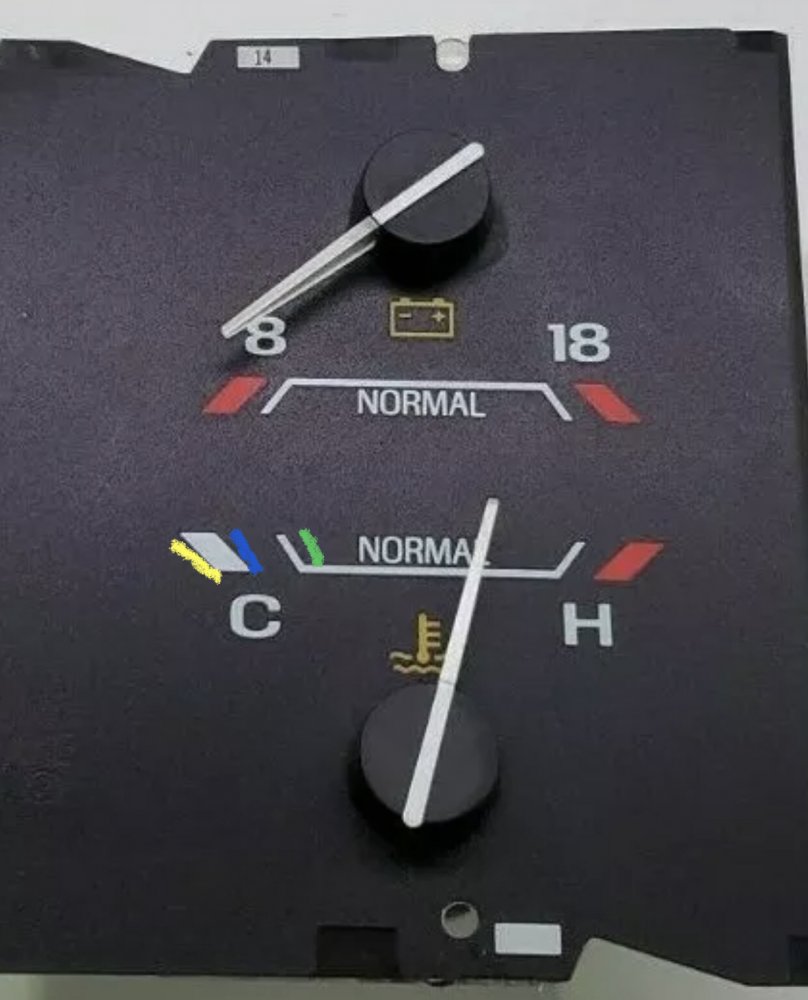

“Normal” is the green line. That’s how it acted when I bought it, and I just went with it. When it’s 45 out, it won’t go past the blue line. Stone cold is the yellow line. I didn’t think to feel how hot the radiator was, but I can’t imagine that 45 is cold enough that the thermostat would be completely closed. It’s just weird that the heater is so much colder when it’s cold out. It could just be that there’s less flow through the block and that’s why it takes a little more from the heat selector.

Dash temp gauge should be just below 1/2 after 10mins, usually 5 to 8min in most engines, 1/2 is 200degF on Ford gauges

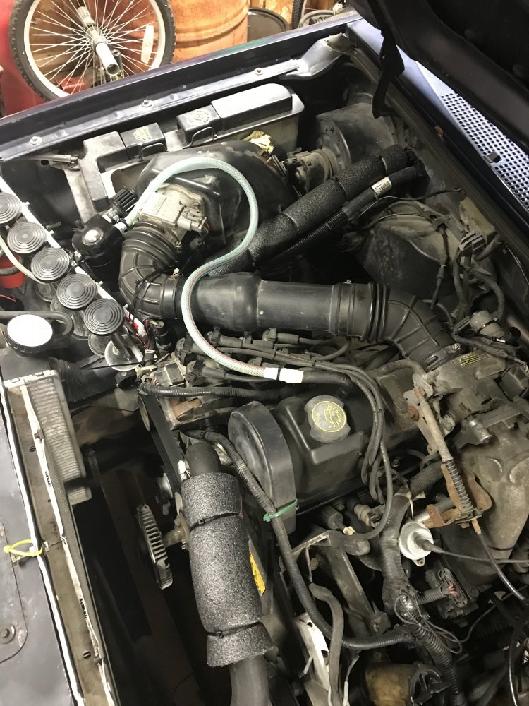

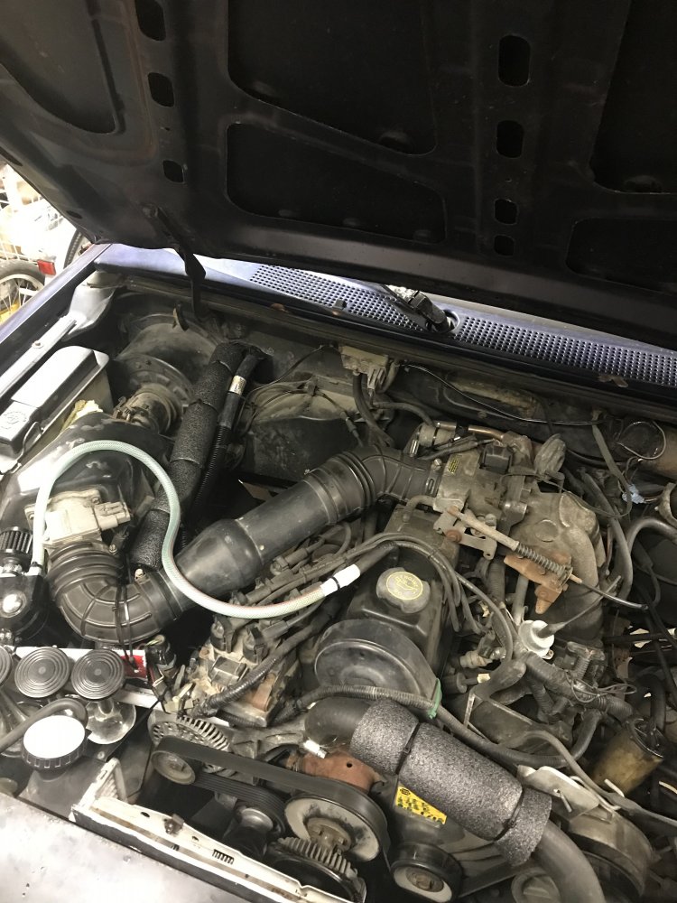

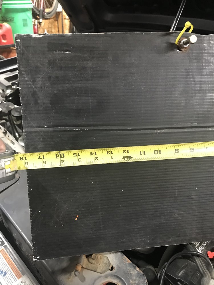

Ive only had (1) 2.3 (out of 3) that had a decent heater, the ‘88. the others, a 92 & the current 94 will keep the window defrosted but youll leave the blower motor on high and never be too warm. Ironically the 88 with plenty of heat (that would have you turning the blower speed down) was a supercab, the 92 & 94 are reg cabs, less space but less heat output, go figure. Ive put foam pipe insulation on the hose from thermostat to heater core, new thermostat, new water pump, new heater core. And most recently Ive removed the fan from the fan clutch. My cardboard block-off is about 50%. It’s better then when I got it but not near as good as the ‘88 was. my next thing to try is to put a shut off valve in the middle of the upper radiator hose. I do need a “real” guage though before I go that route. Haven’t really drove it much this winter, I try to keep it out of the salt brine and let the hhr take the corrosive crap bath. (plus it has a excellent heater) That may change in a few days if we get whats being forcast, the car is awful if not impossible in deep snow, the ranger has more ground clearance and enough weight in the bed to take on some snow depth.

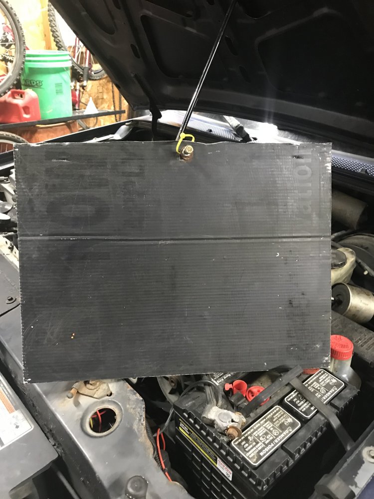

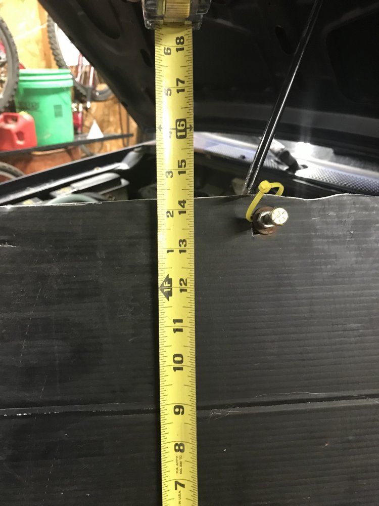

my cardboard block-off really isn’t cardboard but is a cut down corregated plastic political sign, painted black. heres the measurements & a couple other pictures of the engine.

lol first ever vacuum powered air horns
those are dixe horns, compressor is in the corner under them, that vac line from valve cover goes to a catch can/breather. Theres another dual air-horn setup on the core support behind the grille- deer horns, switch for it is on the gearshift. ( see deer/downshift & hit brakes, pull up on switch to hopefully scare deer away. (remincint of a two-speed axle switch from 2+ton grain trucks ,back in the day)
