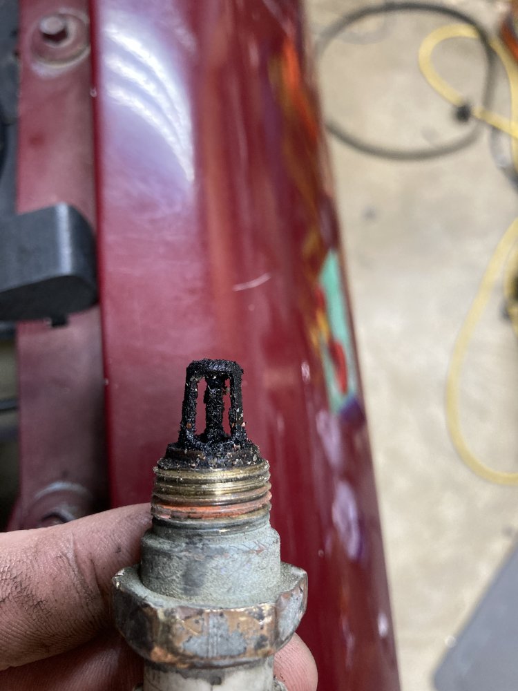

Pulled the IAC to gain access to FPR, I’ll post a pic of IAC. It has huge amount of oil baked on, can’t be working well.
Replacing shortly (IAC).

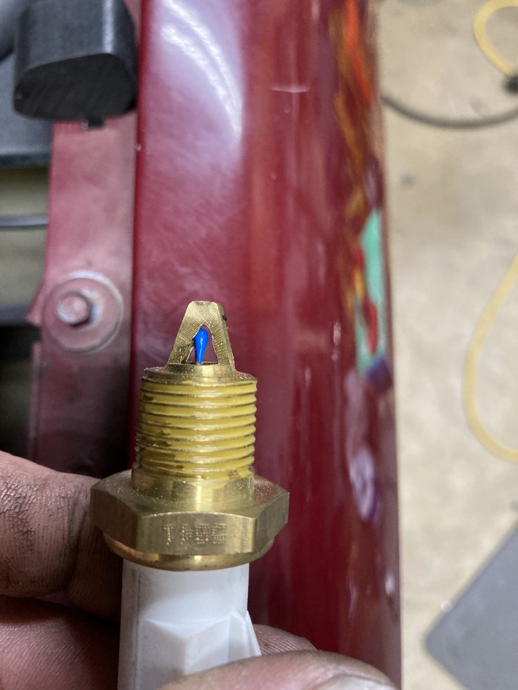

Anyway—— take a look at the IAT before and after pics and the leak down videos.

From some recent experience I have at work an exhaust backfire at startup is going to be from a too rich situation (an intake backfire is too lean, but not too common at startup), if the pre cat O2 sensor is sooted up it could be suspect, burning the soot off with a propane torch could get it working again... you can test it with a digital volt meter, it should make up to a volt when working, the signal wires are the two that are different colors, the two that are the same color are the heater.
The soot/oil on the IAT probably aren't the best but I wouldn't worry about it too much, it'll just slow down the signal which isn't a quick response signal anyway...
Scott,
I believe the IAT foul is from the prior engine and its likely oil issues(engine is a JYD replacement) and Im sure the intake was swapped over w/o cleaning. Why bother, right???

So I expect the O2 sensor to look pretty much as bad as the IAT or worse.
And I am sure it is a replacement. Its too pretty on the outside.

Oh, I understand, you've been through a lot and auto parts are a pain anymore between finding anything and getting a good part...
The intake air temp sensor is just a thermistor, changes resistance with temperature, not much to go wrong with them, I imagine the clean one should be fine, they're not near as fancy as an oxygen sensor that generates voltage...
