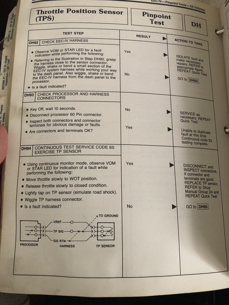

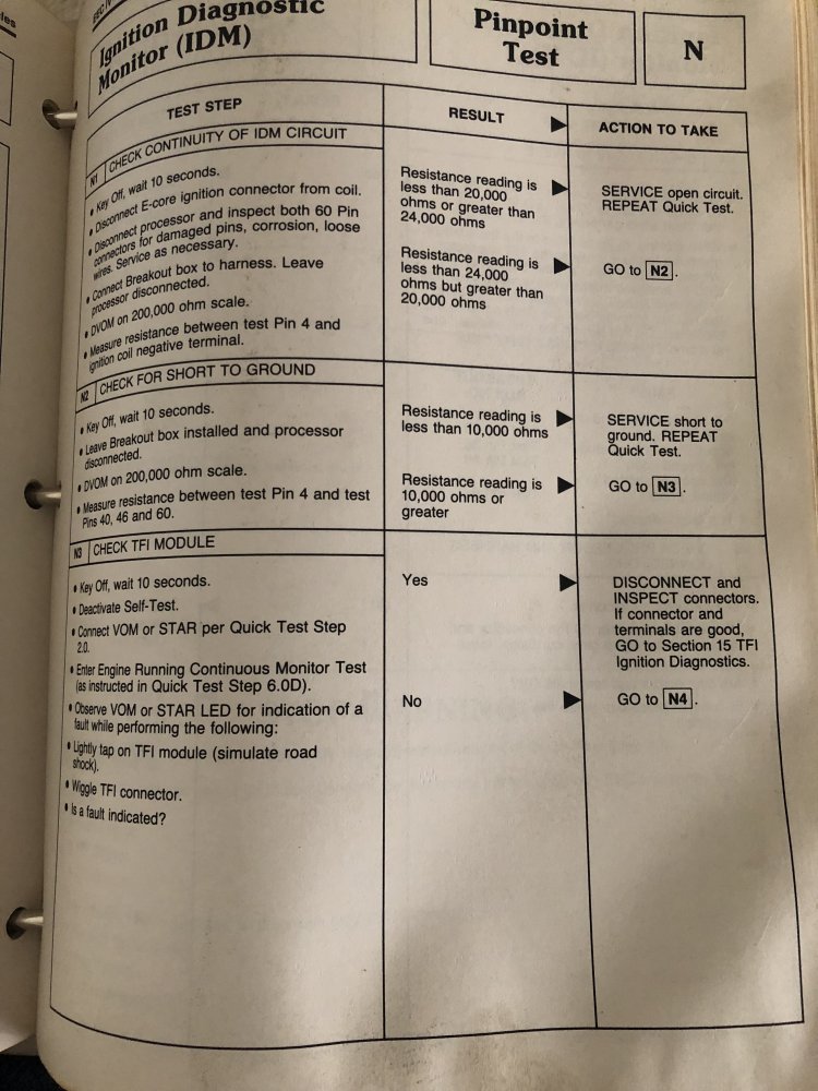

These will help.

Picked up a new TPS and installed. No more code 63. Still getting the code 18 loss of tach. Pulled the ECU and started checking wire. Spout tested good. Checked for resistance across IDM resistor. Nothing coming across resistor. Removed it and tested again. No reading. Did some research and found it should be 22k resistance. Can’t find one like it but I’m reading you can replace with a radio shack 22k 1/8 watt resistor. But I got a parts truck. Pulled that one off and tested. 21.7K. Perfect. Installed cleared codes and took her out. Ran codes when I got back. Success!!!! No more code 18.
