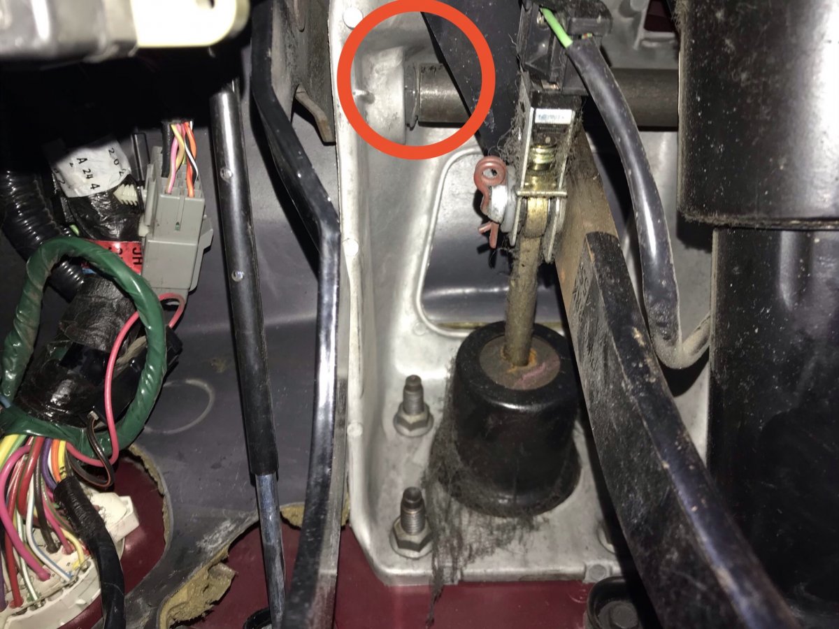

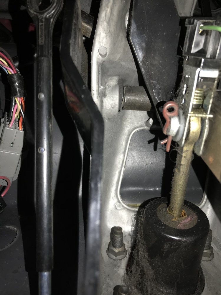

Under the knee bolster, at the brake/clutch assembly they used aluminum to mount the pivot points for both the brake and clutch pedals. They inserted a plastic or similar material bushing. I am not referring to the little clip that holds the clutch pedal to the master clutch rod, but to the right of that, as identified by the red circle in the photo.
The plastic insert wears out, the hole becomes oblong, and changes the pivot point enough that even if you have a new, fully bled master and slave system, the pivot only allows for partial deflection of the clutch rod and doesn’t move the slave (you can measure the deflection at the slave to check this).
Thus, it will grind and “slam” into gear, if you don’t catch it soon enough, it will take out stuff. No amount of bench bleeding or a new clutch assembly will help until you replace it.
If the hole has become oblong, the whole assembly will have to be replaced. If you are handy around a lathe, you may be able to machine an insert out of brass or something more substantial than plastic. If you are lucky and it isn’t oblong, make sure when you replace the insert, to apply a generous amount of grease.
