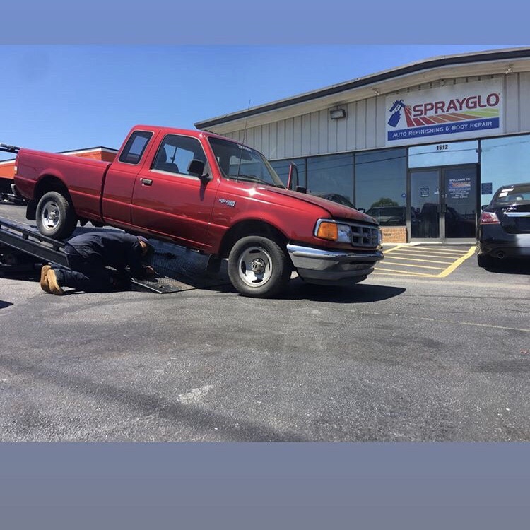

I have a 1994 Ford Ranger XLT
I was looking to drop it, I was thinking about going with a “DJM Suspension”
Kit, and probably using there shocks.
The truck is currently completely stock with no modifications.
Any suggestions???
