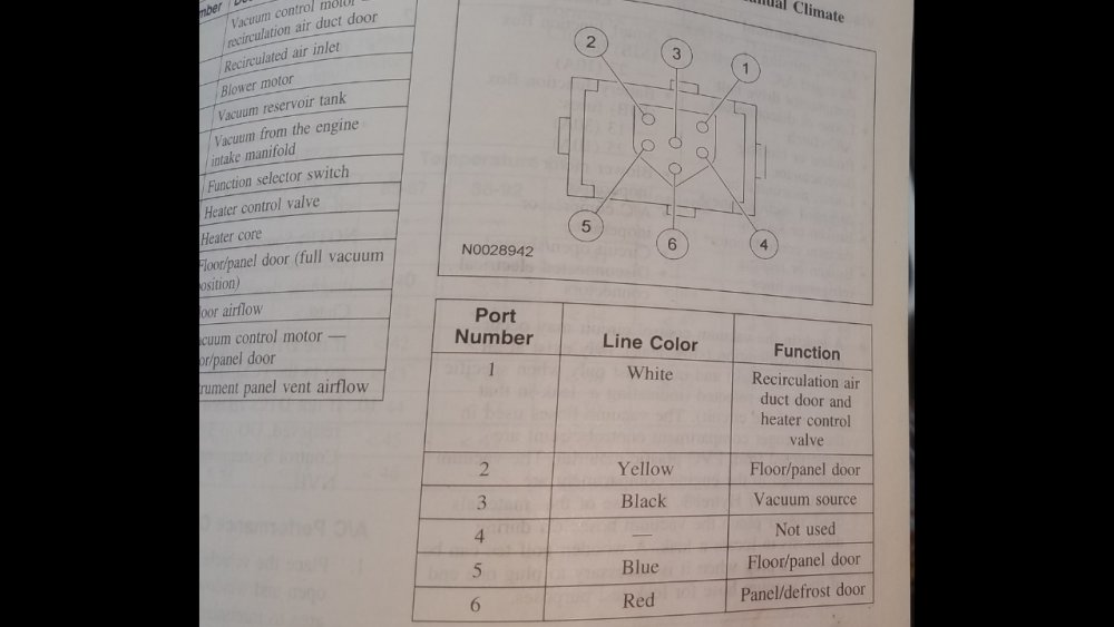

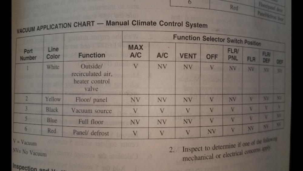

If it helps any here is the vacuum line diagram and control setting chart. Sorry they are pics from the manual I couldn't scan them.

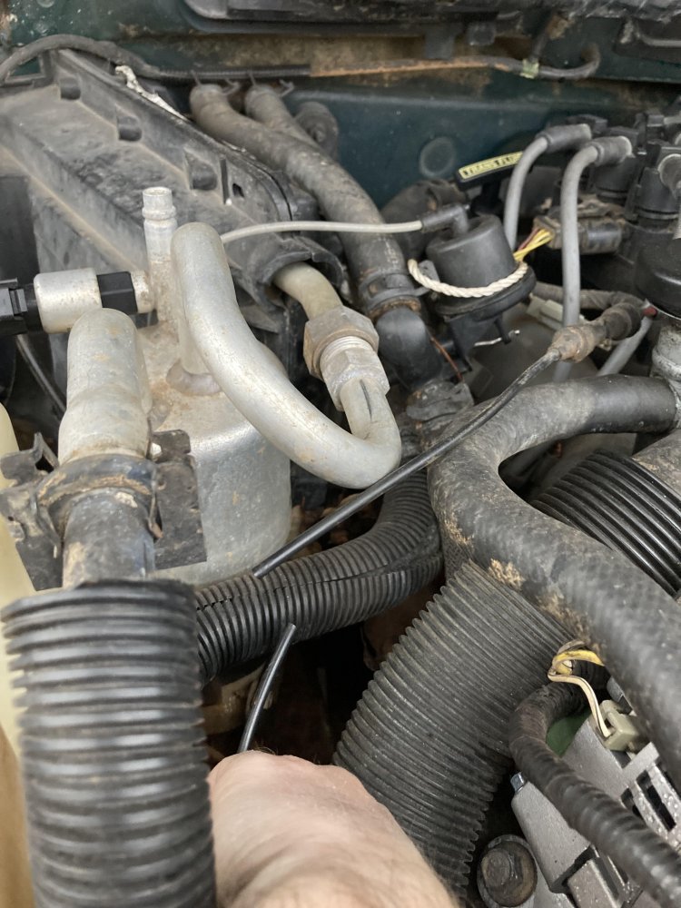

Resurrecting this post from the dead since I am having the same issue. My vacuum line to the engine snapped in the middle and I've been looking for a replacement all over the internet the past two days. Have not had any luck so far. Anyone have any idea for where to find the right size vacuum line to fit a 97 4.0?
Any chain auto parts store should have various rubber fittings. All you need is a coupler with the same (1/8"?) opening on both sides.
fastpakr, thanks for the speedy reply. Yes, I do think 1/8" should work fine. My only concern was that the ends of the line have some bulk to them and may have other components that a straight line might not have.
