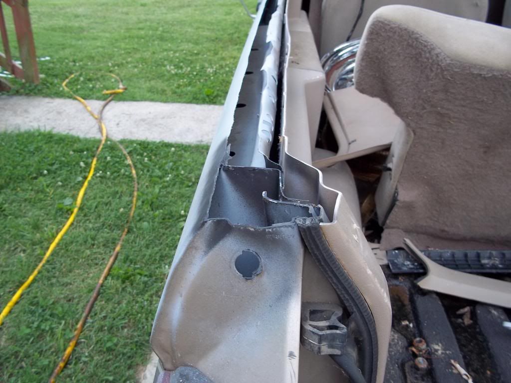

After months of searching, i found this 89 BII with the worse chop imaginable.

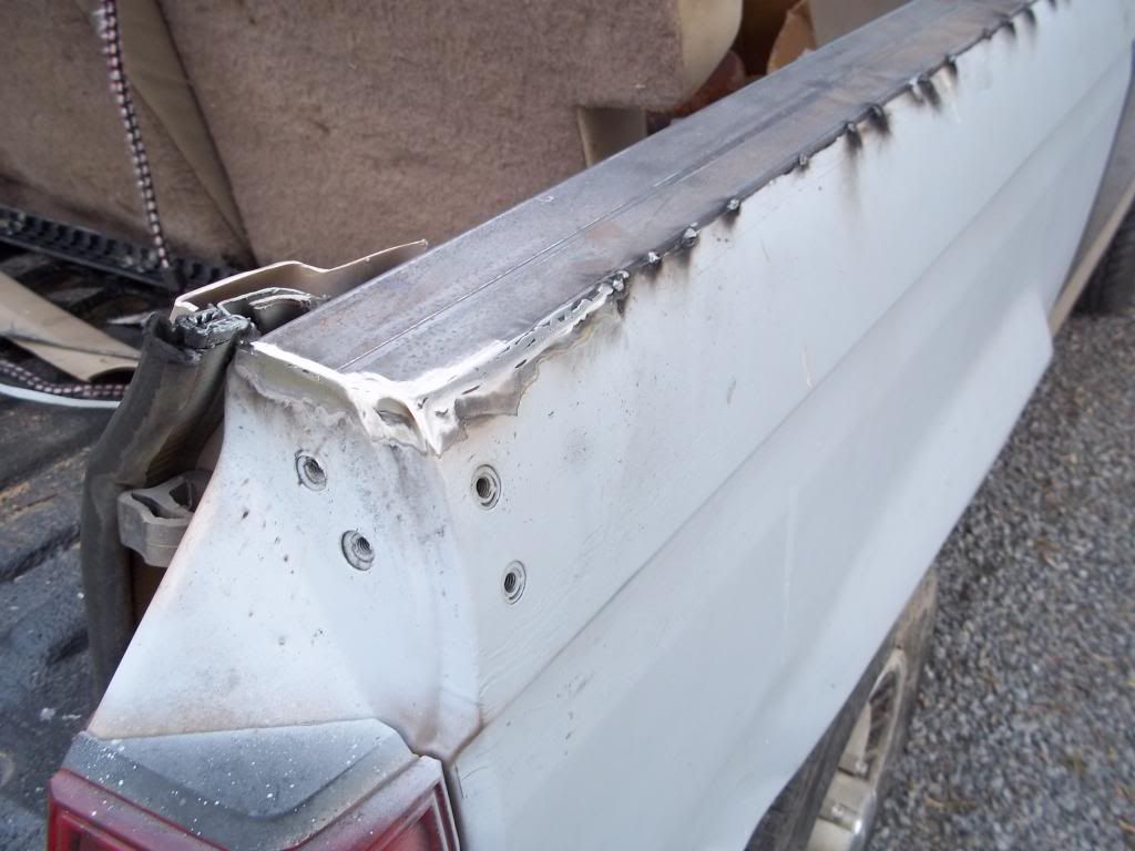

So first step was to start capping off the sheet metal with some 1x3 tubing.
i will update more as i upload more pics.
worse imaginable?
The previous owner cut around all of the pinch weld for the windows with what appeared to be a dull hatchet. i still have a couple of spots to finish. I am trying to find some pictures with the tubing finished.

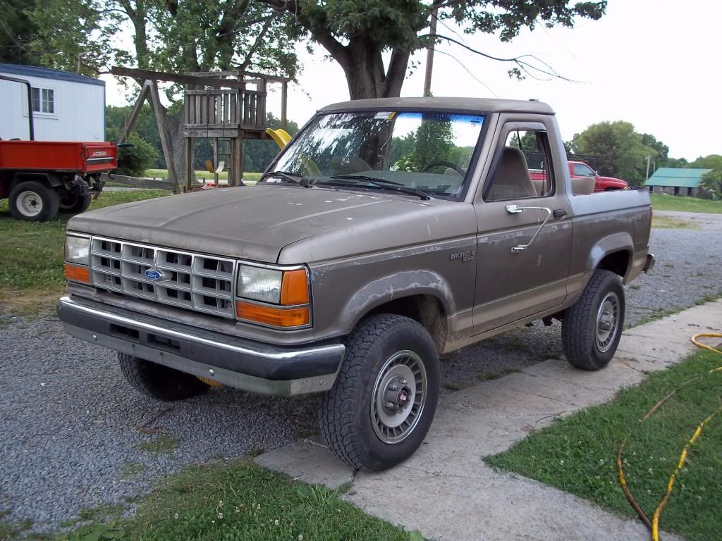

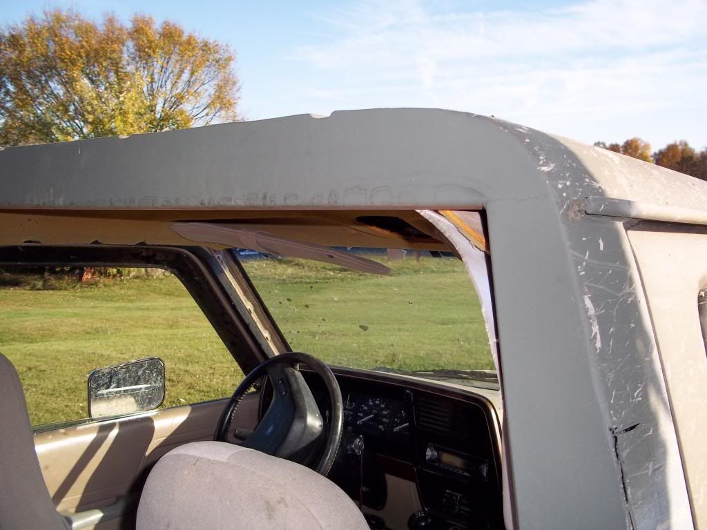

I found a few more pics of the metalwork. I cut down the rear hatch and moved the hinges to the bottom. As far as the top goes i made a temporary partition for the winter, but i have a couple of different ideas in my head.

I don't have any more pics while i was capping the sides. Here are a few more after photos to give a little better idea of what i did.
It was alot of work, but it was the only way i was going to be satisfied with it. It will still require a little attention before paint.
thanks for the additional pics. I like what I see. So what are these other ideas you have for it?

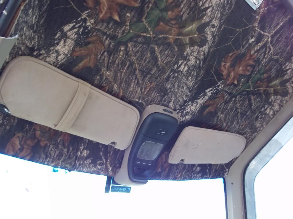

Haven't had much time lately to work on anything, but i did manage to recover my headliner.
