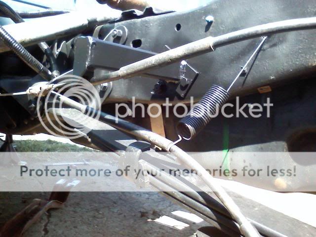

need someone to post a pic of their ebrake bracket they made to keep it in the factory location after installing chevy 63-64 leafs. ive seen one before just cant find the thread it was in. gonna have a buddy make one this weekend and would like it as a refrence. thanks in advance. :icon_welder:
look in the sticky about 64" leaf swaps in the extreme suspension.
I wanna say around page 8?
PlumCrazy had a bracket in his build thread.
I believe that is the one I was directing him towards.
I just read through the whole 11 pages looking for info a doing the swap on a b2, so its certainly there somewhere...
I have my old bracket laying on the shelf. $25 shipped anywhere in the 48
Sent from my DROID RAZR using Tapatalk 2
and those were the ones i saw in the other thread haha. thank you very much.

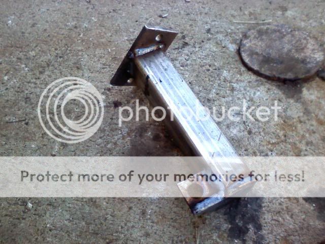

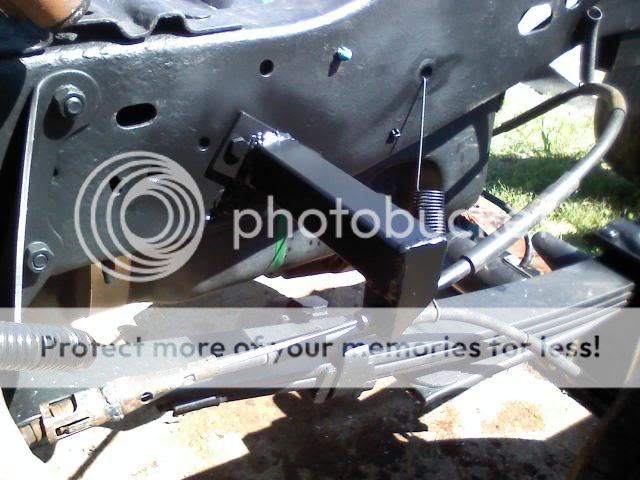

Parking brake cable bracket on my BII (disc brake rear w/Explorer p-brake cables):
