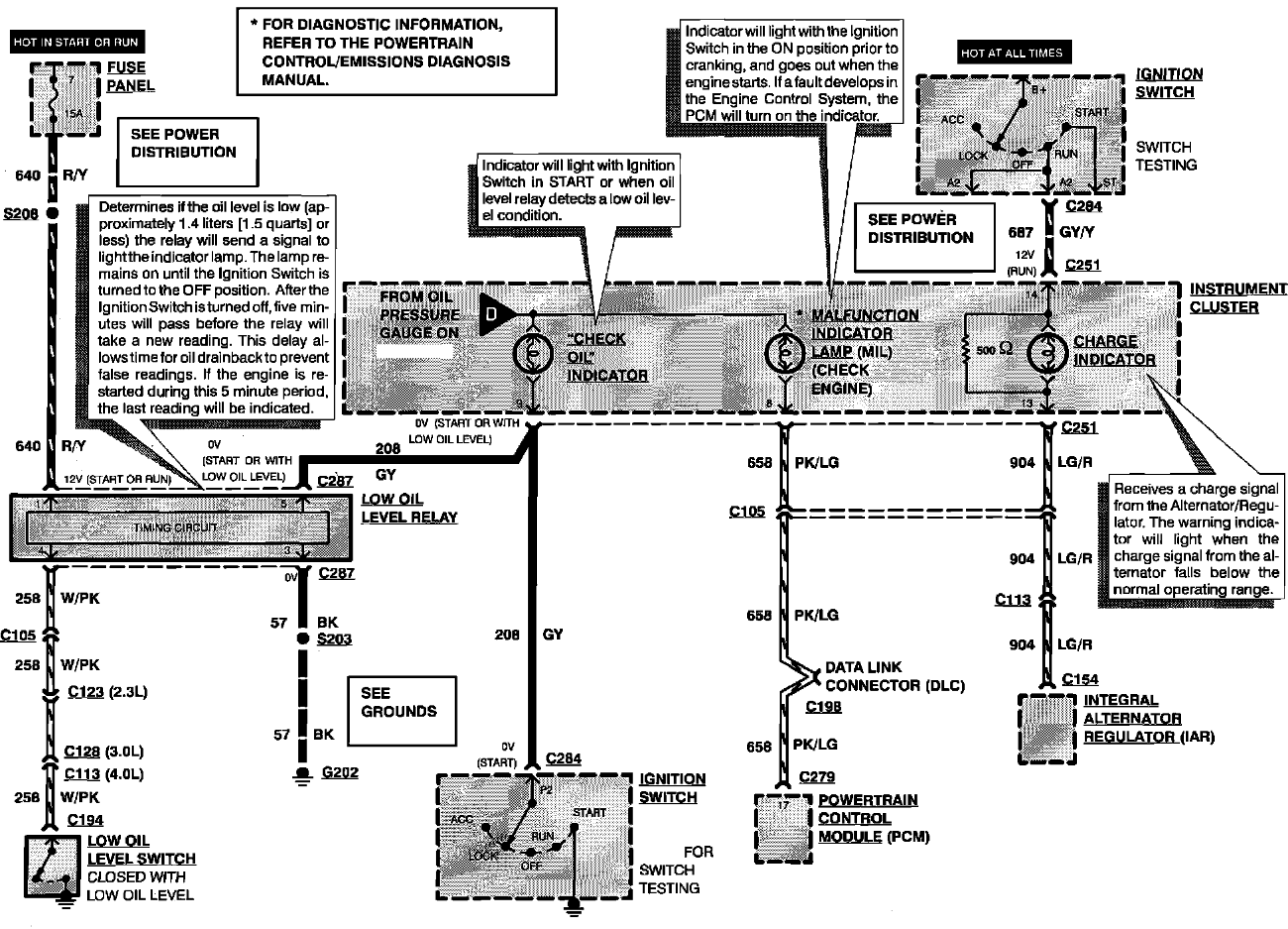

I assume your temp, fuel guages work? The check engine light is fed voltage from fuse #7, 15 amp which also feeds those gauges. That is where the "D" in the diagram below comes from.
Also in the diagram below, you can see the wire for the light also goes to the data link connector, which since this is a 1994 I am going to assume is still under the hood. This truck is not OBDII yet correct? You could turn the key on, then ground the pink/lightgreen wire at the data link connector and see if the light lights up.
If it doesn't light up, you might have to get into the cluster again and make sure you have 12v on one side of the bulb with the key on.

You're right that it's pre-OBD II. All the other gauges and lights work and grounding the wire at the connector did not cause the light to come on so I'll check for voltage at the bulb tomorrow.
