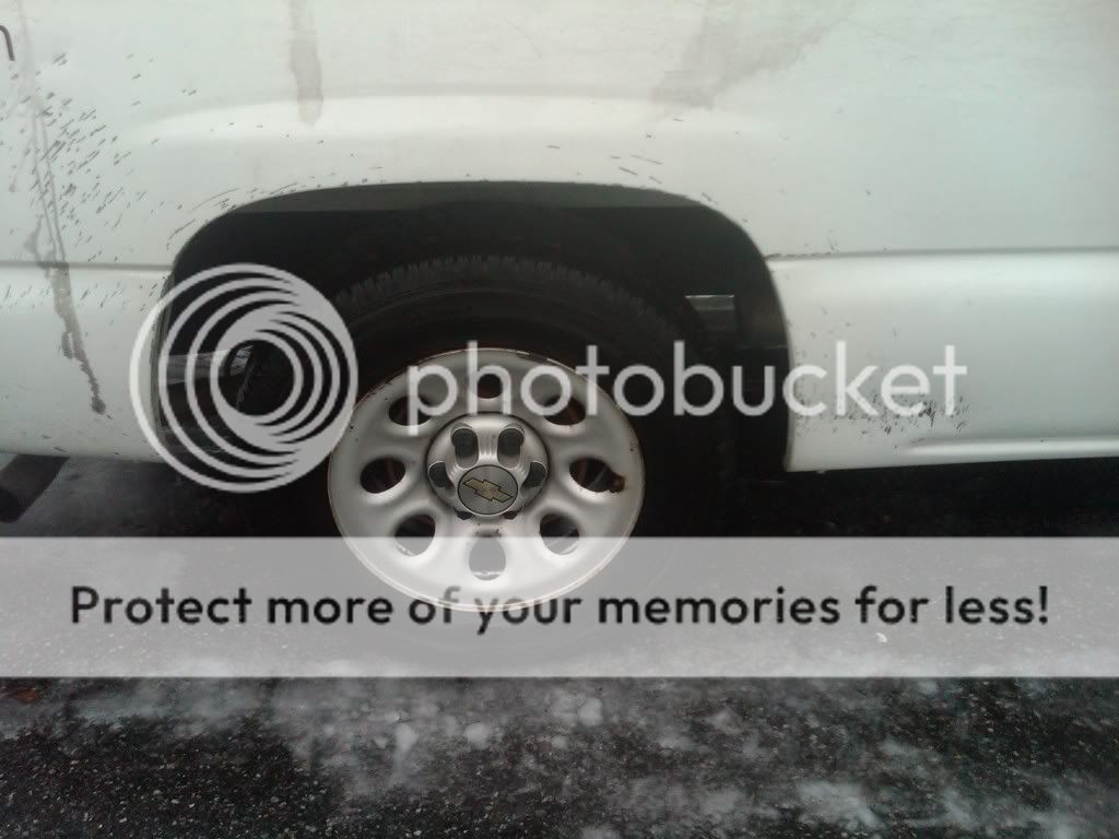

like the title says, the tire chain broke and took half the truck's paint with it.

The problem was they were "emergency chains" that only cover part of the tire and strap through the hole in the rim via a heavy fabric strap like those found on tow straps. a great idea in theory but I didn't pay attention to how thin the rims on that truck were. The metal on the wheel actually cut through the strap. I'll post a pic of the chain type when I get home.
