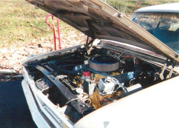

My last hotrod was a 472" 1971 460 in a '64 Galaxie. It ran 13s on pump gas with iron exhaust manifolds, quiet mufflers and a 3.00 axle with a C6. I used a 600cfm AFB, and used ALL of it. It had razor sharp throttle response and pulled to 5,000rpm.
Do you want to go fast or brag about your parts? Get the right thing on there.
