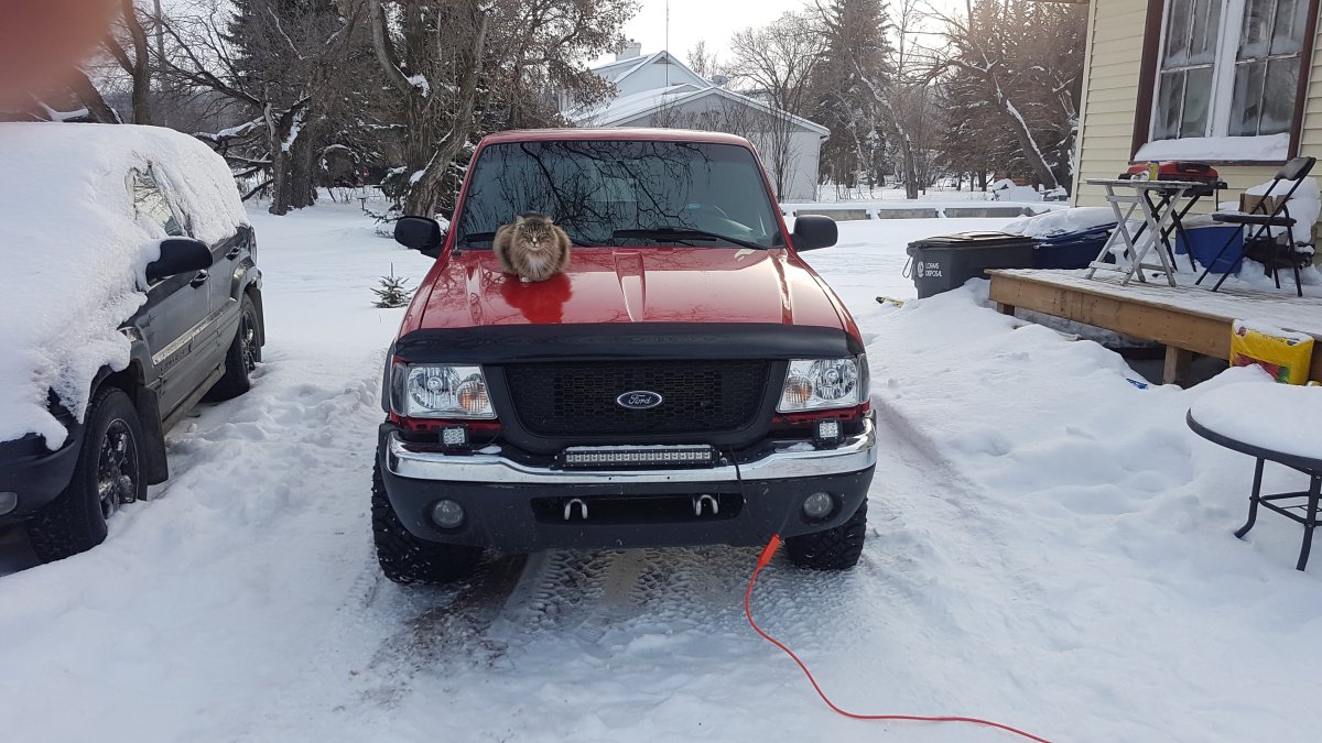

They are about $50 at NAPA. I installed mine on passenger side of block. You can get to it by removing the wheel and fender skirt, Not to bad of a job. I can send you a pic of location if you want. Cheers from Saskatchewan.
