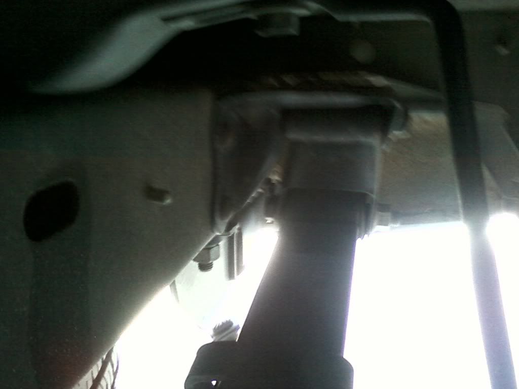

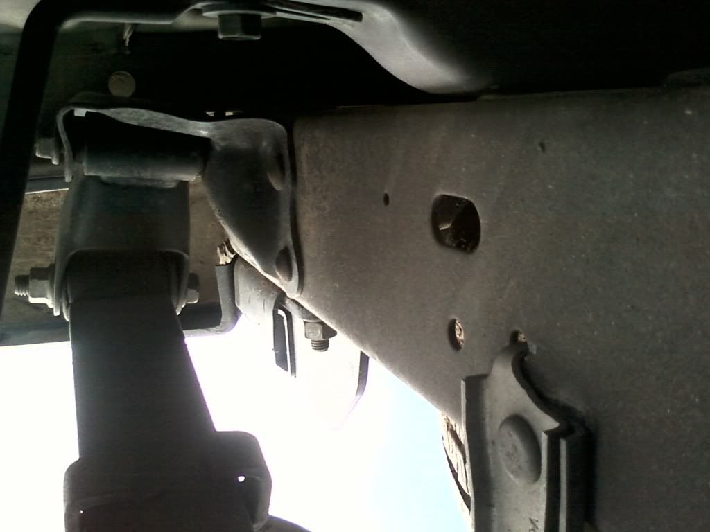

heres pics of my hangers and shackles now and I'm pretty sure it was in an accident before I bought it cuz my axle is from on 02 but mine is an 00
Drivers side
Passenger side
If you flip the hangers it will drop ~2". If you then install longer shackles it will lower that much more.
You could flip the hangers & install add-a-leafs to get back to ~0"
