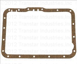

Hey, all.
I’m thinking about putting a thin film of black RTV on both sides of the cork gasket going on the auto transmission pan of my 1992 Ranger with the A4LD. I’ve always used cork gaskets and never had one leak before, but I’d like to have a little bit of extra insurance on this one, in case there are any devisions from absolute flat on the pan (thus, the RTV).
I feel like a long time ago, someone may have told me to use either cork or RTV, but not both. There was never an explanation why and I’m starting to wonder if I imagined it.
Thoughts? Thanks. :icon_thumby:
You can... But it's pointless and just makes the next time you remove the pan more of a pain in the ass. Use a gasket or RTV, not both. Only time you would want RTV and a gasket is on multi peice gaskets to seal the joints. A quality gasket and applying even torque in a proper sequence is all you need for a good seal.

Cork gaskets swell with fluid contact which makes them work well as trans pan gaskets, or valve cover and oil pan gaskets.
But they are not reusable after a few months of use.
I have used RTV to hold cork gaskets in place, not really for sealing the gasket.
You need to be careful with RTV in that when you tighten the bolts the RTV will be squeezed out, and on the inside of gasket it can come off in little balls that can clog screens and filters
So use sparingly

It’s a fiber compound that won’t squish out like cork. More forgiving than cork on torque. You can spray with high tack or shellac. I use them dry and have been for 30 years with no problems.
Not a fan of cork gaskets at all. Knowing what I know now, I wouldn't use RTV with them either... especially on a transmission... although I will admit to using both together in the past.
My trick with gaskets is to smear just a little dab of grease on both sides so that it sticks to whatever you're applying it to... this is especially helpful with transmission pans and oil pans, keeps it from moving around when you're putting bolts back in.

Yeah, I’ve used a touch of white lithium grease on them in the past. Never got into using the high tack spray-a-gasket with them though (always seemed messy and unnecessary). I asked about a light coating of RTV because I’ve always wanted to try it, but also worried about bits of it breaking loose and making their way into bad places. I’ve never had a cork gasket leak in over 30 years, but the few times I’ve used rubber (especially those half-cork/half rubber abominations that my ’86 F-150 used on the oil pan of the crappy 300 ci), they always have. Can’t stand the things.
