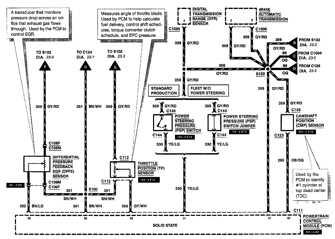

I have a 99 ranger xlt with a P0340 code (Camshaft Position Sensor) the truck runs fine at idle but it bogs down when it’s under load. I’ve replaced the camshaft sensor and the code is still there so I started looking at the wiring and I don’t have any voltage to the sensor. I checked both wires for continuity. The ground has continuity and the hot goes to pin number 85 has continuity so I figured the ECU was bad and I ordered a new one and replaced it and I still have the same issues I have to be missing something any help with this would be greatly appreciated. On a side note I’ve also replaced the alternator
