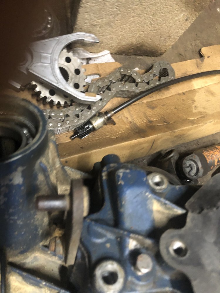

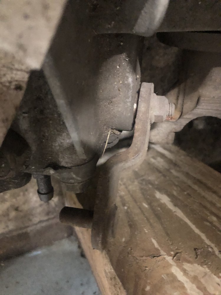

Shifters on the A4LD/M50D/ FM146 will all bolt up . The difference is in the linkage and how the linkage or plate (whatever you want to call it) is bent where it slips into the lever on the TC . Here are the 2 linkages .
