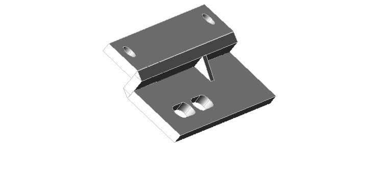

For the later Rangers with the torsion suspension, yes you use the stock Explorer V-8 mounts. With a coil suspension you need to use the SOHC V-6 mounts on the frame and some plates from them to the motor. Brain B (Ford engineer) has the plans that they used on one of the SVT project Rangers.
Drivers side looks like this.
Other side is basically a flat plate. Drive shafts are the last thing to worry about, way too many variables between swaps.

I can get you those plans, Brian is really hard to get ahold of now adays.
I'll PM you.
I'll PM you.

That would be awesome mang! Thank you!!!

Mac, I would love to have some of those mount plans too, can you get me a copy?
