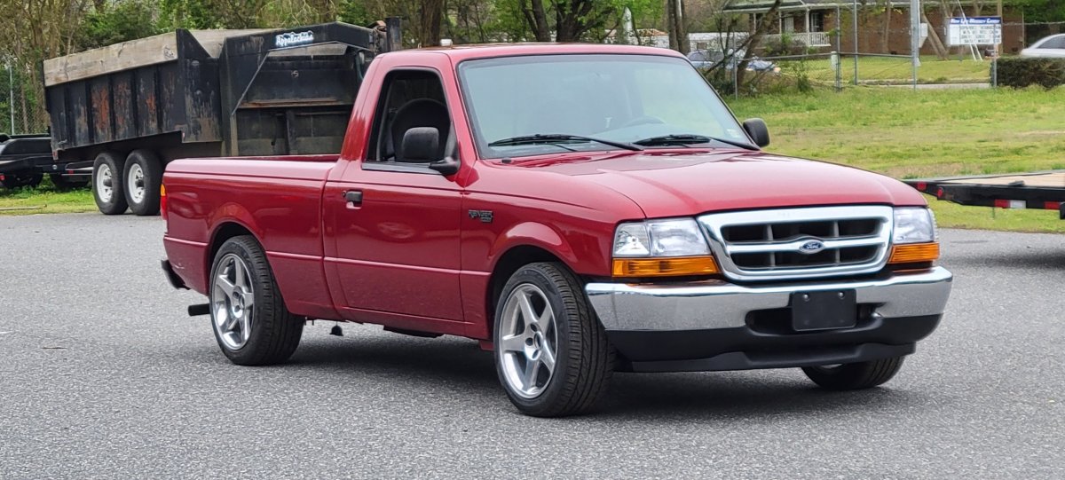

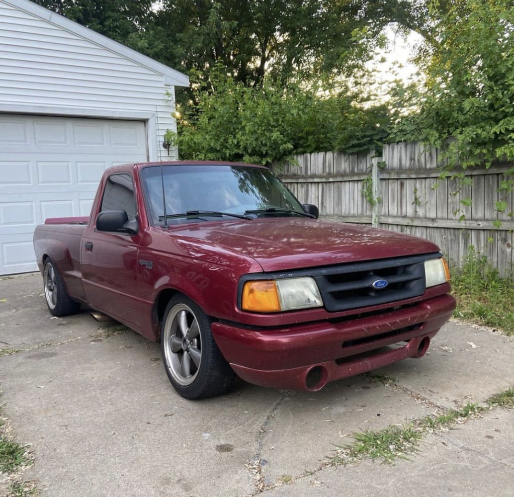

Will a foglight bumper from a gen 3 ranger like this:
Fit on a 4th gen ranger like this:
I don’t mind doing bracket swaps and wiring for fog lights etc as long as there’s no cutting involved.
Just need to know if these will bolt up or what I will need to get them to bolt up.
I'm gonna say "probably". The gaps may be different between the bottom of the lights and grill to the top of the bumper, but then again it may look just fine. If you don't already have the bumper. look at a bumper from an Edge/Sport, that has fog lights, within the same generation.
I've looked at the bumpers from the current generation, but I just think they are kind of ugly. The 3rd gen fog light bumpers, however, look like a truck variant of the SN95 Cobra bumpers.
