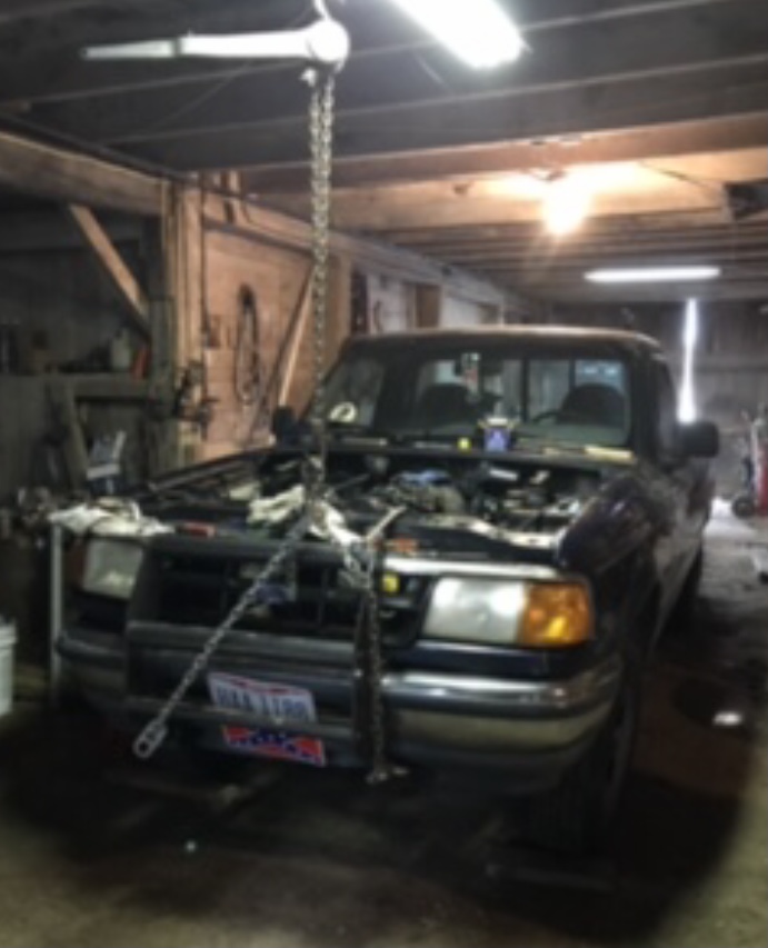

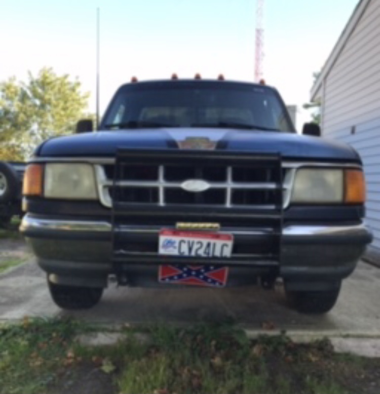

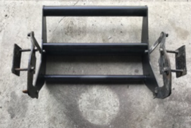

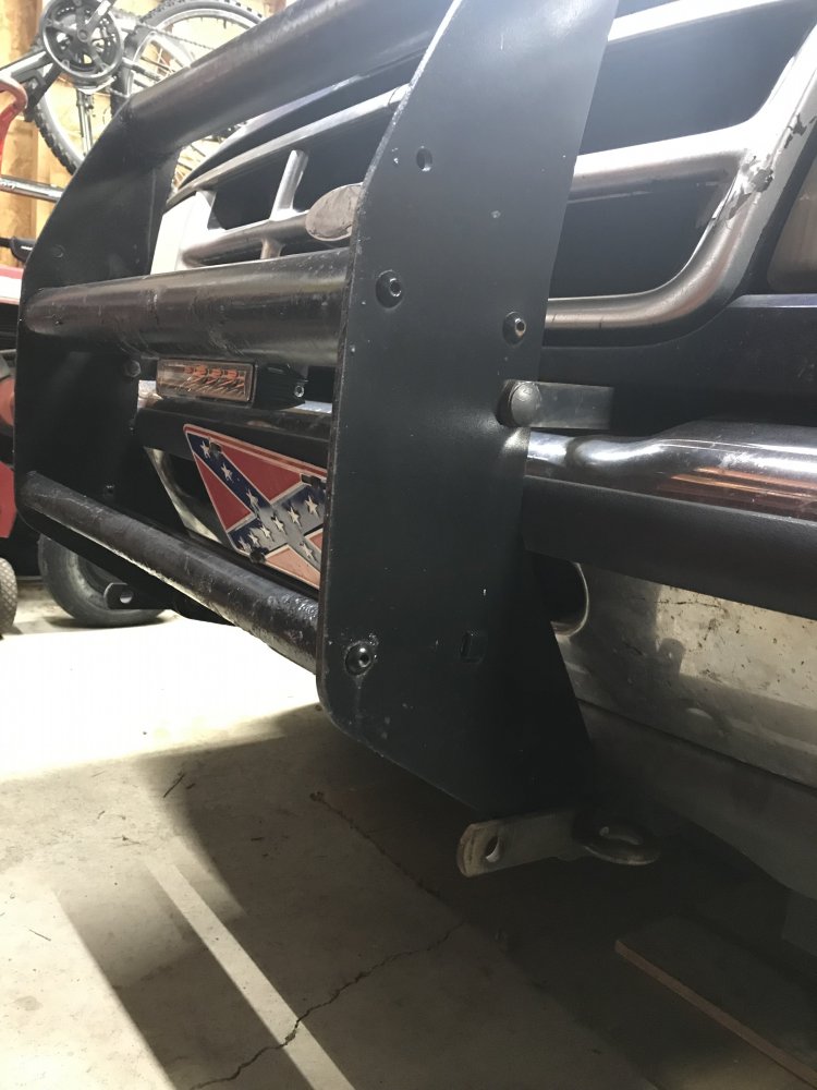

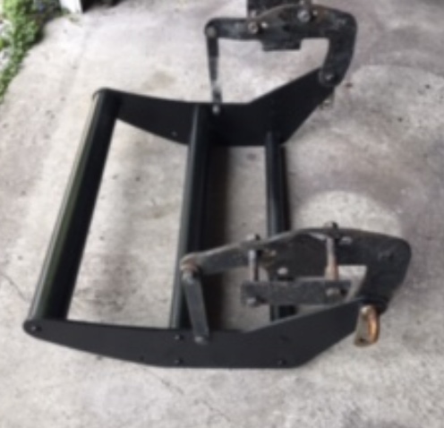

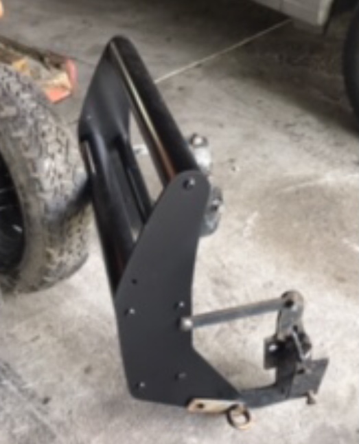

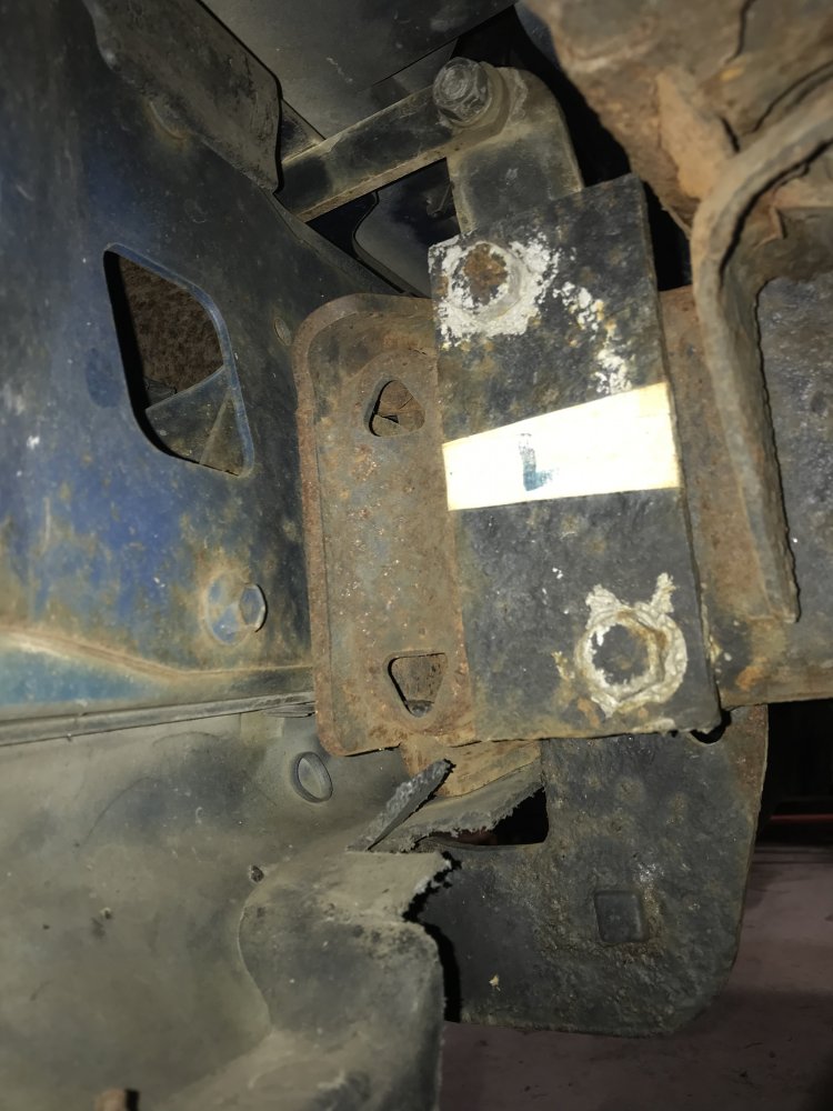

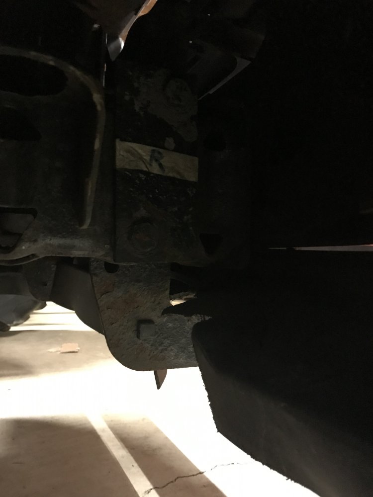

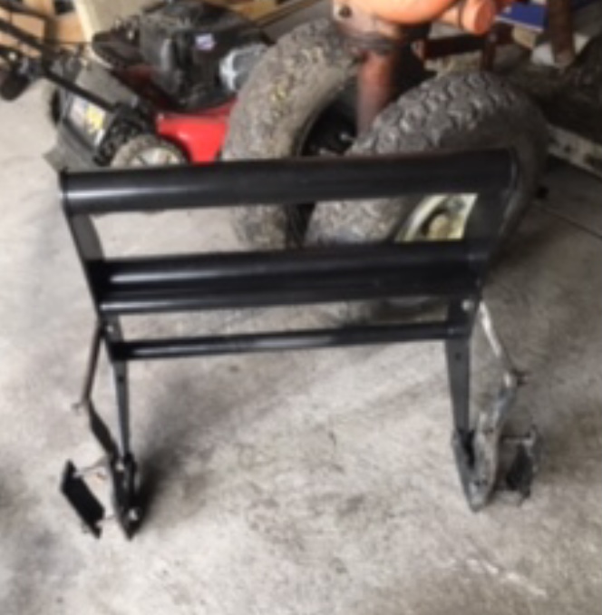

The warn trans4mer on my 94 was originally on my 93, I bought it new in 2003, the mounting bracket’s basically clamp around the frame horn, 1 bolt on each side goes through a existing hole in the frame. it’s plenty strong, Ive hit deer with it (the 93 truck, not the current 94) Ive used it as a lift point to raise the entire front end of the 94 with a chain hoist. The ranger is in the garage right now, I can try to get some pictures & edit this post, not sure how good they will be, kind of dark under there & everything is painted black.
for some reason I cannot edit my post to add photos, in looking through my photo gallery I found pictures I took of the grille guard some time ago when it was off (between trucks) for my future reference, brackets & bolts are in the spots they would be for installation. the underneath photos of course arent great but without a lift or lights its the best I can manage at the moment.

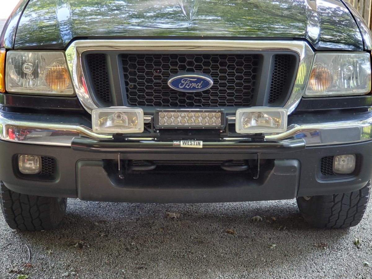

I didn't read the whole post so I'm not sure what you are looking for but I bought a Westin Bull bar that mounted fairly easy to my 04 Ranger FX4. I did have to reverse the hooks that come through the bumper and I put a 3/8 inch thick aluminum plate to mount a set of lights. Didn't need that heavy a plate but my son got it free so why not.
