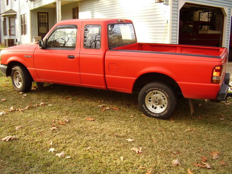

My little 94 Ranger is starting to look its age. I took it to the local classic car detail shop today to ask them about buffing and waxing it for me. I was figuring $100 or so.
The guy took one look at it and told me I’d be better off taking it to MACO for one of their cheap paint jobs.
I bought the thing new and used to wax it and wash it every 3,000 miles when I did the servicing on it for the first 10 years, it has been taken care of well. The paint doesn’t look that bad to me, a little faded and chalky from oxidation and one scratch on the side where it got keyed 13 years ago. I had my 16 year old boy attempt to buff it last year and he left wax all over it but the paint looks too good to me to sand off and repaint.
BTW, if it needs repainting I will do it myself.
So what do yall think, anyone got any good tips/tricks for revitalizing old paint?
What products and methods should I use to strip it down to the bare paint and polish and wax it back to looking like new?
Or am I better off to just drive it like it is or paint it?
Here is a pic of how it looks now;
It looks like you may be able to polish it with a buffer and get the gloss back. I did a two stage polish on my truck over the summer. It took a long ass time but the results were great. The paint wasnt as faded though. I used a Porter Cable dual action polisher with Megs 105 with Lake Country orange pads and then 205 with a black pads. Im not sure if it will bring the gloss back on yours though and it will take awhile to do it too. After the cost of the polish, pads, polisher, and time you might be better off with new paint

Should I use rubbing compound or what? What grit or brand and what kinda pad on my cheap electric buffer?
No matter how much you wax it it wont get the gloss back. If you wet sand it be very very careful you dont remove all the clear coat or it will never be glossy.
Maaco does a pretty decent job for what they charge, ive seen a couple cars maaco'd and they looked just like stock.
It doesn’t look to me like it has or ever had any clear coat on it?
I know when I tried to polish it a few years ago the sponge turned orange and the run off water was orange when rinsing. Also over the years when waxing the sponge would turn orange. I always figured it had some sort of single stage urethane type coating from the factory instead of 2 stage base/clear?
If I decide to paint it I will paint it myself and put good quality paint on it. I plan to keep this truck for a few more decades.
Wet sand it with 1500 - ---Be easy on the on the edges and don't sand threw the clear.Then buff it out and put a good wax on it.:yahoo::yahoo:
Shoot I would wet sand the clear off and then Hit it with a few nice layers of paint then get a new clear coat on that puppy!
If you wanna attempt to restore it I would get a clay bar and clay bar it first then do a rubbing compound not sure which one I got some turtle wax compound but I might throw it out. wash it again. then try a few layers of really good wax, I like mothers or the Meg's tech paste 2.0. and do a couple coats then hit it with a buffer. if you want you can use an anti oxidizing polish too like I used nu finish paint restorer on my old 84 and its doing fine. Heck never been repainted and its still pretty shiny.
Even just constantly waxing it will probably bring back some shine.
In that case you would be better off wet sanding it till it doesn't do that and spray a good 3 or 4 or 5 more coats of paint and then hit it with a clear because paint can't oxidize if its protected by clear coating.
