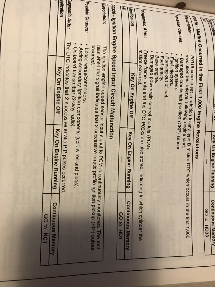

don't get carried away with the parts list.
from the 2005 Ford diag manual.
sorry about being a bit tipsey this morning.
in my experiences when the fuel is dropping off it is not a hard miss fire.
instead it's more like a progressive loss of power, kind of like I'm tired and want to sleep,
happens over a few seconds when the inertia switch is tripped.

so it could be coil/plug related ? The wiring looks fine to the CPS and everywhere else in the engine bay.
at the very least remove and re-seat the connectors a couple times, check for corrosion on the pins.
