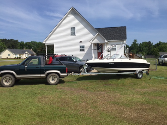

I pull a 18 foot ski boat with mine without any trouble.Its right in the 2500lb range. I pull it about 10 miles each way so not far. Its no speed demon but stops fine, as with any trailer you allow a little extra room. You can feel it back there for sure but no problems.
I usually don't go over about 50 or 55 mainly due to that's what my bimini top is rated for as to not tear it up.
Also my B2 is bone stock drive train wise, 2.9 auto,
A pic of the boat to give you a reference
