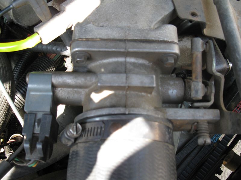

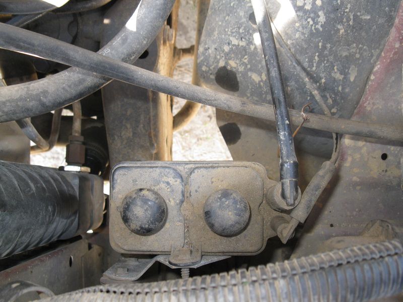

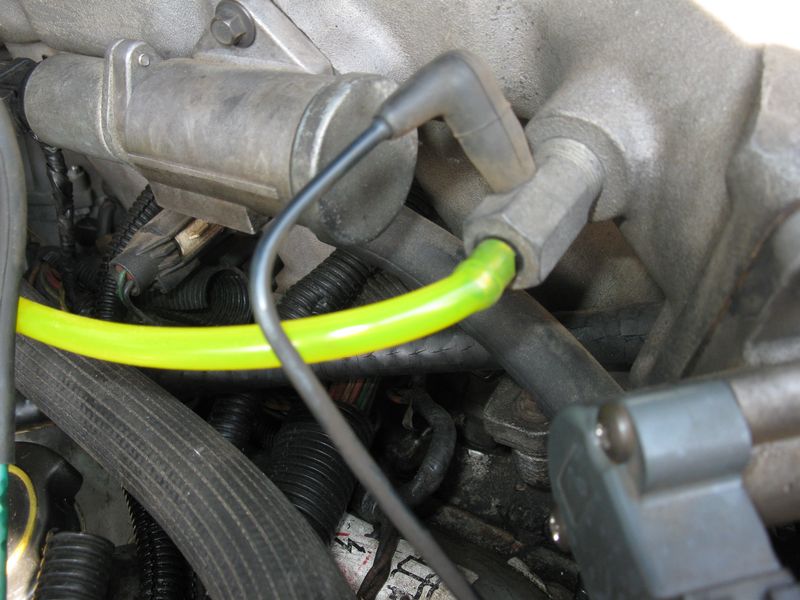

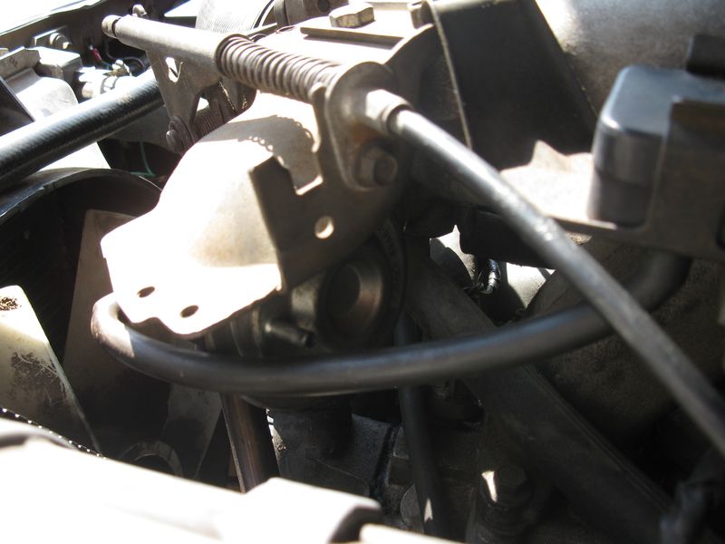

What is this item in the picture and where do the red and green lines go?
On the Bronco II, the green line is broke and is hanging loose.
What about the other items? Which vacuum lines attach to them?
For now, I simply grabbed some clean fuel line I had laying around and hooked some of them up, so ignore the color or hose type.
The thing in the first (from left) picture is the EGR solenoid. The red line coming from it is supposed to go to the manifold where the neon-green line is in the third picture. The other line, the black one, in the third picture, is supposed to go to the MAP sensor, which is shown in the 5th picture with neon-green line hooked up to it. The dark green line in the first picture coming from the EGR solenoid is supposed to go to the open port on the EGR valve, as shown in the second picture. The line in the 4th picture is ok, as the fuel pressure regulator is supposed to be hooked up to manifold vacuum.
I went by color as that's what's in your pics. That should explain where everything's supposed to go. Be careful with those plastic lines as they like to crack and leak.
Thanks! That gives me something to go by! I've got two more though....
The second picture...under it (can't get a shot at that angle) is a broken line, in between two large lines. One large line goes to the PCV valve, I forget where the other goes. The one in between is broken.
What about the line from what I think is called the charcoal box, or something like that (first pic)
on the charcoal canister, the thicker line should step down in size with a metal line, and then run to the bottom of the throttle body. from the sounds of things, this one might be one that you say is broken. the other line on the charcoal canister runs to a vent on top of the fuel tank.
