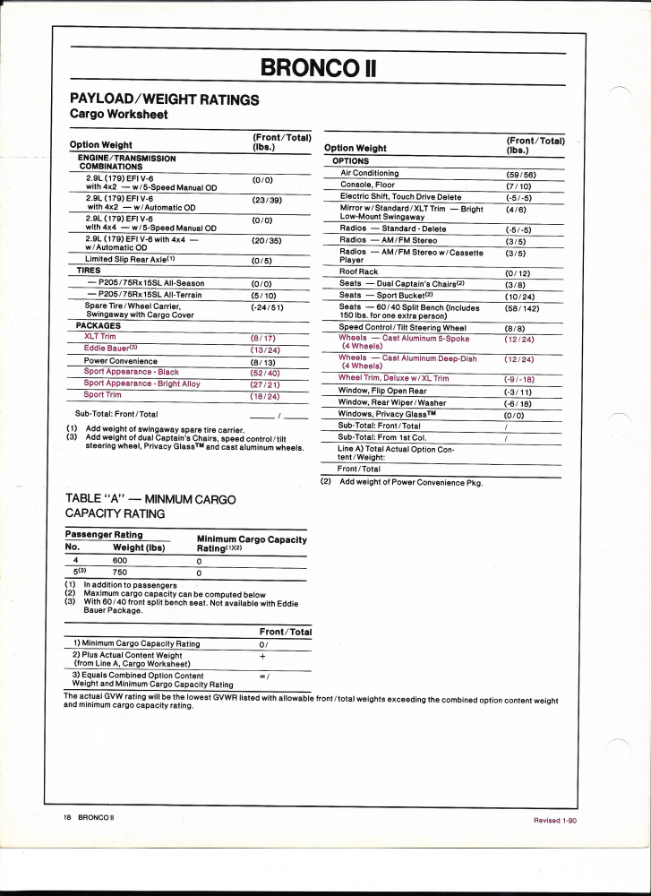

I have owned maybe 6 or so B2 from 1984-1990 and from models XL right up to the (useless) Eddie Bauer edition with the roof console, plus, I worked at a various Ford dealers in parts and as a mechanic and never remember seeing one. I was checking my crash book sheets for the 1980s and 1990s Fords and decided to check my 1990 Ford Sales ordering book and the section for the 1990 Ford Bronco II.
66475
The option weighed 18 pounds and you had to subtract -6 pounds from the front curb weight.
There was never a power rear window option like the full size Bronco had, but there was a rear flipper glass option available, and both the flipper glass and fixed glass rear hatches had an optional wiper/washer as well.
