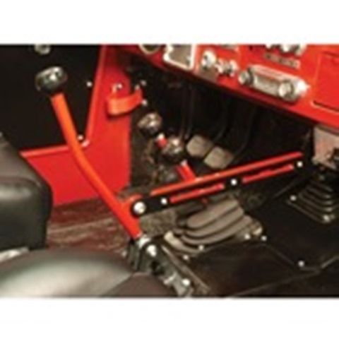

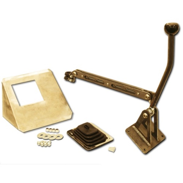

This might work

Personally I like the space that I have between my shifter and the seat now so you won't see me pitting one of those in my truck.
