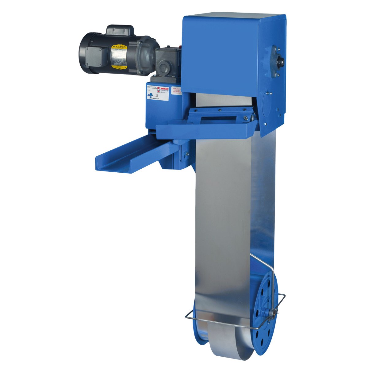

Soaps and detergents are supposed to break down the oil. That's how they get it off your skin in the first place. But, there are other ways to separate it.
The grease trap works, by having 2 chambers. They are divided by a wall that doesnt go the whole way to the bottom of the tank. So, the mess comes into the first chamber, which should be big enough to slow down the flow and allow the oils and grease to float to the top. The clean water is heavier and flows under the partition and out of the tank through an outlet near the top, but below the top of the divider. Grease then cool and coagulate and form solid bodies that can be pulled out. Oils just collect there. It all must be manually removed before the oily mess reaches a depth sufficient to go under the divider.
Oils can be removed with a skimmer. This is usually a motor-driven flat belt that dips into the tank. As the belt rotates back up out of the water, the pil attaches to it. Then the belt runs through a "squeegee" that scrapes the oil off and funnels it to a different container. The belt just keeps doing this continuously. Probably a less expensive operation than a centrifuge.
Breaking Oil Emulsion
Those skimmers are great. We have 2 at work on a 300 gallon tote. We have a lot of oil and water spills in the pits.
