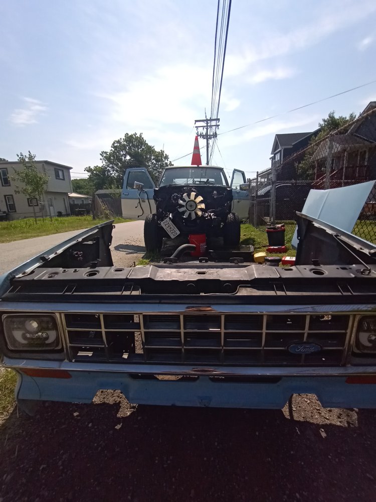

I built a new 2.9l v6. I replaced damn near everything but at low rpm it spits and sputters and overheats. If you're able to get it over 4k rpm it runs great, doesn't miss runs smooth. I deleted the thermostat, checked water pump flow, checked for blocked passages. Timing is set to 10°, FPR is good, fuel pressure is good, compression is good, No coolant intrusion, no coolant leaks, oil pressure is great.
Side note: when I put the distributor on the first time I had the firing order backwards. Instead of 1-4-2-5-3-6 I had it as 1-6-3-5-2-4, could this have fried my stater or my ICM? Could that be my problem?
Edit: I have replaced the ox sensor and fuel filter, nothing changed, the problem seems to go away when i unplug the ox sensor.
does anyone have a wiring diagram to an 87 and an 88 ranger 2.9 (the harness is out of an 88 mines an 87 and it worked fine with the old motor before it blew up)
