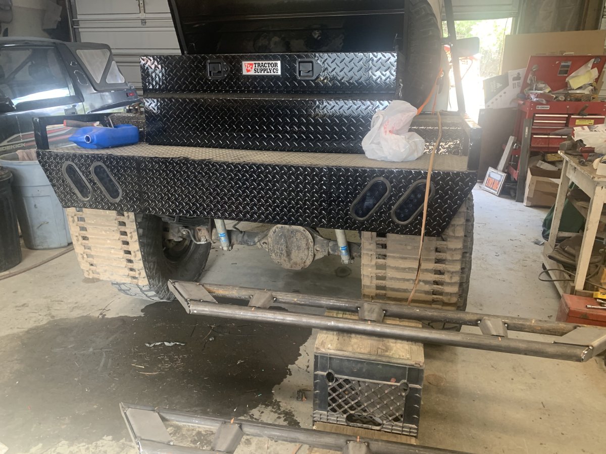

Any one see this when adding LED lights? I'm getting 5 volts to the brake lights. Enough to make them stay on slightly. With a regular bulb you cant see it. I unplugged the brake light switch and no change. When I unplug the turn signal switch the lights go off. I swapped the switch with an used one, and now the LEDs are even darker and i'm getting less than like around 2 volts. I ordered a new switch but I don't know where it could get stray voltage from other than a shorted wire right? I unplugged both the flashers and my brake switch and they stay on. I'm going to try a new turn signal switch and try that first.

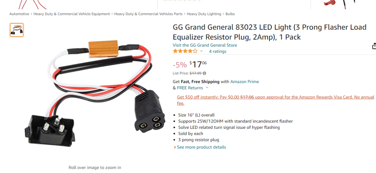

So I got my new multi-function switch in and its I still have the same issue. Dug into it some more, tested wiring from tail light plug to the plug on the fender no issues found. Good Ohms. I pulled the Multi-function switch down and its letting voltage by almost 6 volts. so with the part of LEDs having limited resistance I plugged in to regular condescend oval lights and everything is working as it should. The multi-function switch shuts power off like it should. Voltage went to zero and my battery draw is gone. So I'm guessing I need to wire inline resistors in. Do you think these would work? I made the tail light wiring a little short so this will kill two birds with one stone. But not sure how many i need or if these will even work? Internet says a 3157 bulb has about a 2 amp draw so I'm guessing these should work.
