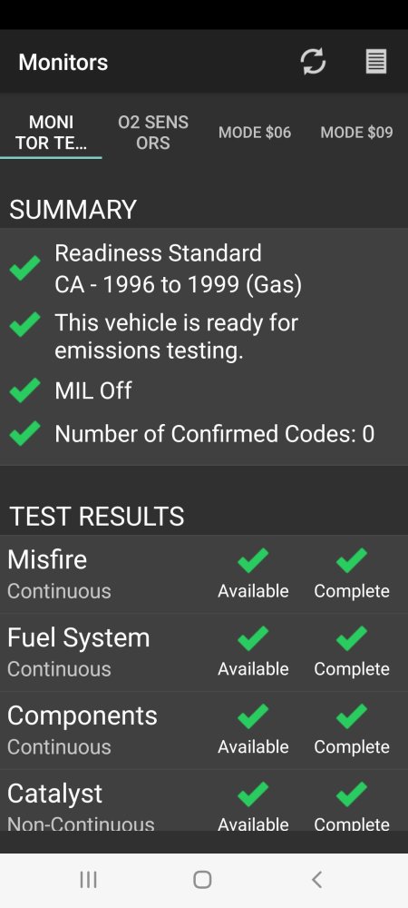

UPDATE: So the short answer is yes, A bad PCM can and will trigger P0135 & P0141 (Heater circuit) for both O2 sensors simultaneously and in error. I managed to clear the readiness codes, and pass smog today.
The steps:
  1. Checked all fuses
  2. Replaced both O2 Sensors
  3. Confirmed voltage and switched grounds at each O2 sensor
  4. Confirmed ohms and load for each heater circuit
  5. Checked grounds at engine
  6. Did thorough voltage drop tests across all ground points and key fuse points in the engine fuse box
  7. Ran secondary +12v wires to rear o2 heater to supplement in case of occasional gap
  8. Replaced both O2 sensors again.
  9. Over 18 test drives - each triggered the errors after 6-8 miles
  10. Replaced the PCM
  11. Ran readiness drive cycle, clearing all codes, and .. passed smog.
