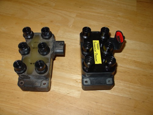

I found the the 4th cylinder had no spark. I tested by pulling the plug, and holding it against the head with vice grips. I started off replacing the wires since one looked a bit corroded when checking the plugs. The plugs all are a nice grayish and clean. I swapped in a new coil (ultra power performance coil) and now have spark at all cylinders. I found the coil I got is actually for a 97-98 3.0 ranger. It has the vertical plug. My truck had the horizontal stock, so I had to adjust the plug wires location to get it to even run.

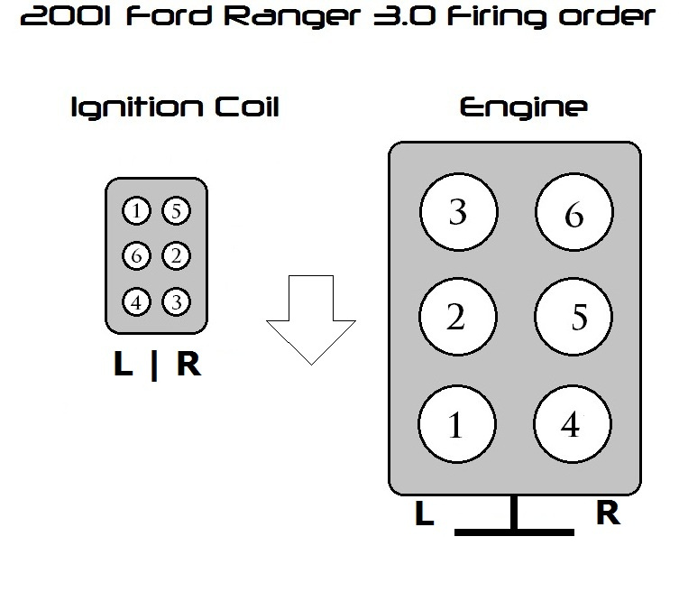

I linked the image I found for the 3.0 plug wiring, which now that I look at it, IS the same as the 4.0 plug diagram, just layed out weird. Following that diagram made it very difficult to clip the plug wires onto the coil because they cris-cross but thats how it runs best.

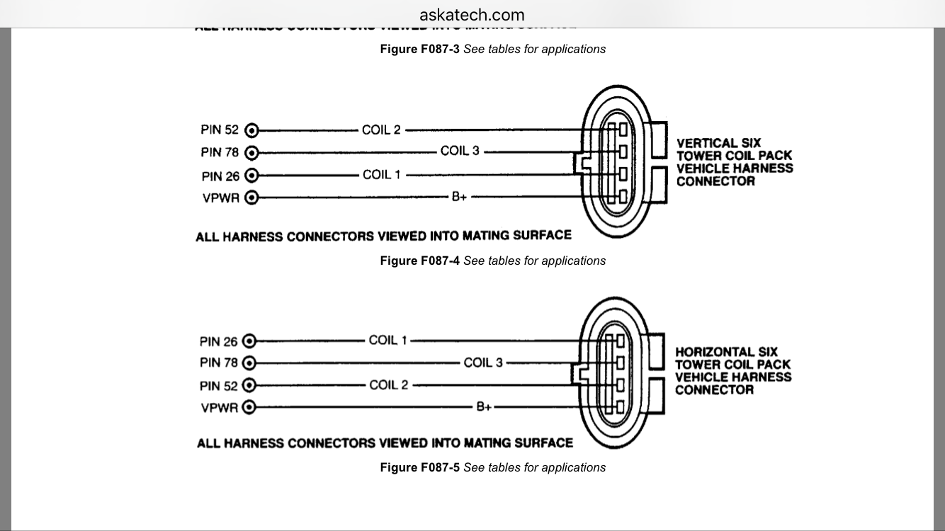

The second image I am linking shows there apparently is a difference in how the coil is wired- coils 1 and 2 are reversed between the horizontal and vertical coil plugs.The other shows the two plug types- my original was the oem in the pic- horizontal, the aftermarket I received is like the screemin demon.

3.0l coils are mounted on divers side and backwards, coil #1 in back, on 4.0l, its passenger side coil #1 in front
That explains the diagram I posted.

Essentially this coil is wired backwards from the original OEM.

If the 4 wire connector is on the passenger side then it would be opposite of the way you have it.
But if connector is on drivers side then that way would be correct, coil pack is just rotated 180degrees
